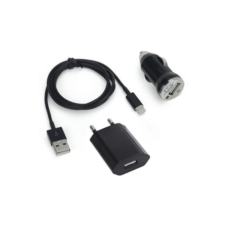

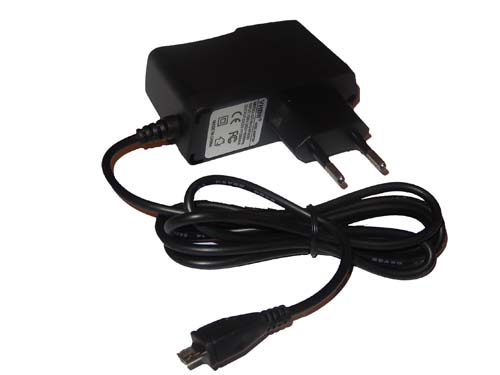

one is a normal wall to micro USB cable which say 5V 2A which DOESNT work at all
picture: http://www.handy-foto-pc.de/pics/akkus/rlmicro2a.jpg
the second one is a Wall to USB plugged to USB to MicroUSB cable which works almost ok.
picture: http://img.tvc-mall.com/uploads/details/I5-753E-1.jpg
