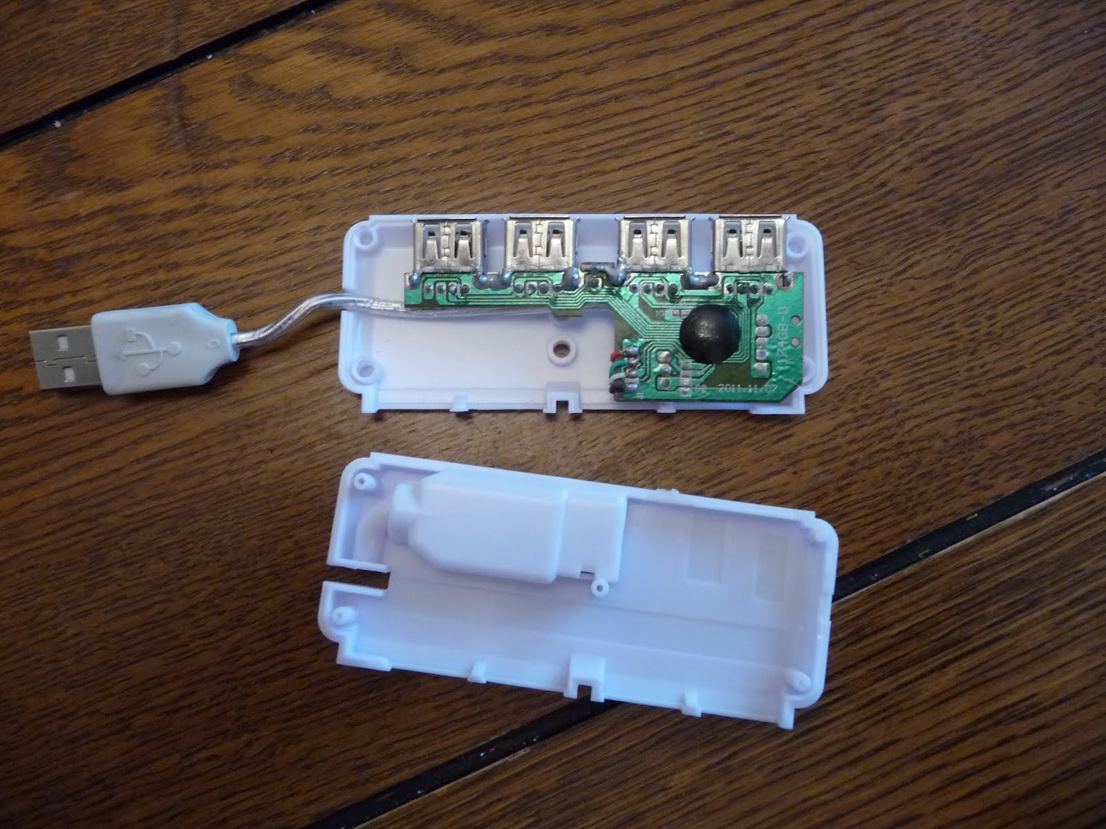

Surprisingly easy to open (and slots nicely back together as well) - nothing suspicious (hi-res of the backside here), so firmware I guess...

That's pretty evil, embedding a webkey into a hub. It looks like it's only calling up Google, but it could have been worse.

...surprised it didn't output something along 'Hackerz Inc - U R pwned' :lol:

Bought one of these from Poundland then remembered this thread. It does exactly the same. Winkey+R then "www.google.com"
I know my soldering is pretty bad but this is disgusting for a retail device...
