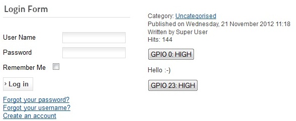

i installed joomla on my raspberry pi and use WiringPi to control the gpios.
I want a easy use of the gpios via joomla.
So i manipulate an existing joomla plugin for my use and it works fine :-)
When i write {gpio}23{/gpio} in the editor of joomla it creates a a button on the homepage to toggle the pin :-)
Here a screenshot:
But if i try to build my own plugin it does not work.
I can install the plugin but it has no effect.
