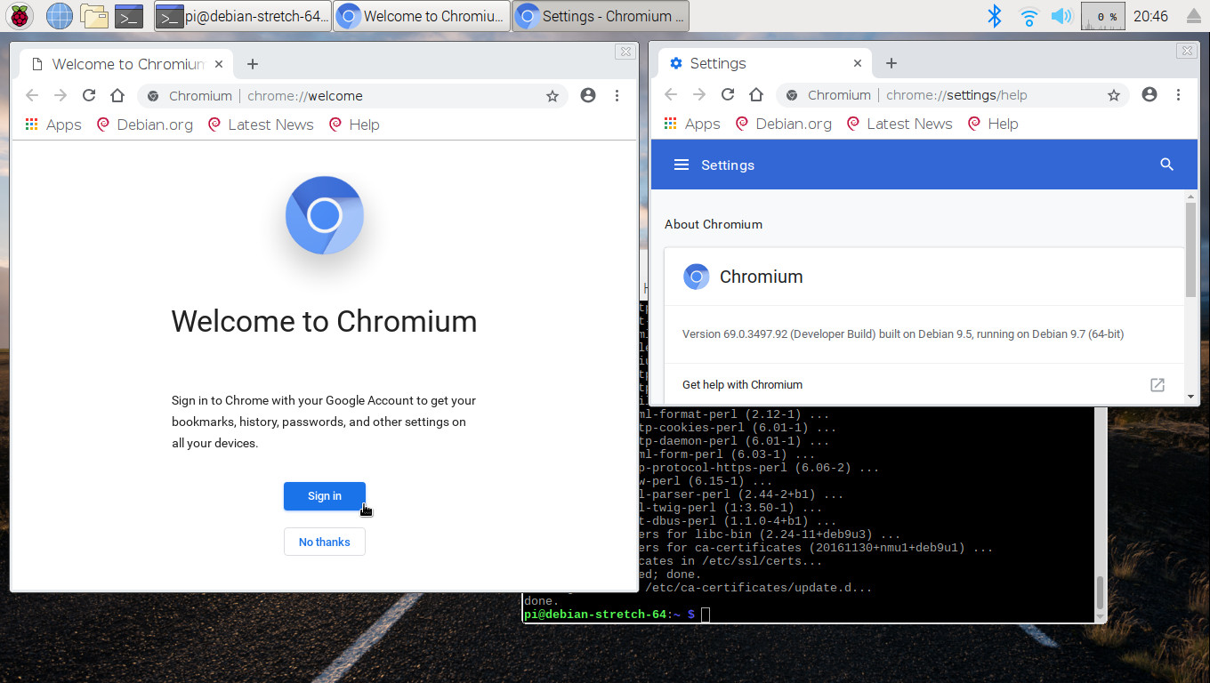

I've just released v1.1.0 of the bootable image on GitHub, here.
As before, you can burn the image (~925MiB compressed) to a microSD card (>=8GB), then boot your RPi3 from it directly (the root partition will be automatically resized to fill the card on first boot, per the standard Raspbian flow). Full instructions for download and use are provided on the project's GitHub page.
With this version of the image, it's now really easy to try out 64-bit applications from the Debian Stretch repository, while remaining in a familiar 32-bit (userland) Raspbian environment!
For example, say you wanted to try out the 64-bit Chromium web browser. Begin by downloading and booting the image onto a spare microSD card, following the instructions on the project's GitHub page.
After two minutes or so (subsequent boots are much faster), you should be presented with the usual Raspbian first-time setup wizard:
Follow this through as you would for a standard Raspbian startup, making sure to setup networking when prompted, and to reboot when prompted, once the software update step has been completed.
When your RPi3 comes back up, select System Tools -> Terminal (64-bit), and a container shell terminal should open. There's nothing to configure or set up; it's ready for use immediately!
Issue sudo apt-get update in this 64-bit container shell, followed by sudo apt-get install -y chromium, exactly as you would if using a 32-bit terminal:
Once the install completes, a menu item for your new package will automatically appear in the host desktop (new v1.1.0 image feature ^-^):
Just click on that menu item, and your 64-bit Chromium browser will open!
And that's it! Programs you install this way have full access to your home directory, and can play video and audio on the host desktop. You can, of course, still install and use 32-bit apps from the standard Raspbian repository, just as you would before (use a regular, 32-bit terminal window when installing these, of course!)
64-bit integration with less of the headache ^-^
Further details of how all this works under the covers may be found on the project's GitHub page, and in my detailed tutorial, here.

Ok so I got it up and running, and after installing my favorite apps (took fairly long time), below is is the screen capture of the desktop.
also installed 64bit Kodi, however it does not seem to run. have installed the 32bit version as "backup".
Also installed 32bit programs just to be sure.
Hope to see Kodi 64bit running in in the future too (no rush though)
any other 64bit apps/program suggestions welcome. I'd like to try those as well.
(accessed and posted on this forum using the 64bit chromium on RPi3B)
