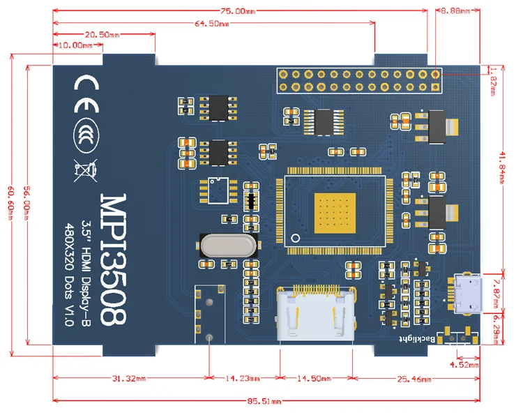

How is the display (physically) connected, ie. what type, size of connector - photo. perhaps?

DirkS
Posts: 10371
Joined: Tue Jun 19, 2012 9:46 pm
Location: Essex, UK
Re: 3v out when lcd occupied the pins
Sun Aug 19, 2018 6:10 pm
FTrevorGowen wrote:
Sun Aug 19, 2018 5:16 pm
https://ae01.alicdn.com/kf/HTB1I7hPSXXX ... c99ccf3554
26pin GPIO connector. Screen is HDMI, Touch probably uses spi0.1 and 1 or 2 more GPIO. and of course power / ground pins
