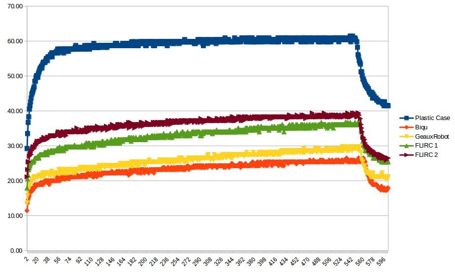

1) The heat transfer was better than anything I've tested so far, though I've not found that many passive cooling cases and won't shell out close to $75 to get one of the Wicked Aluminum cases. I've attached a graph of how this case's temperature rises while running "stress" on all four CPUs.

3) NO FAN - I wanted something that could transcode 1080p video for Kodi and run all the emulators in RetroPie, that puts a lot of load on the CPU and that means heat. With most other sub $10 cases the CPU would get throttled as it hit its thermal limits which meant that the video and games stutter and lag. Other people elect for fans on their RPis but I find fan hum really annoying. This case uses the entire case as its heat sink so that fans are not needed.
