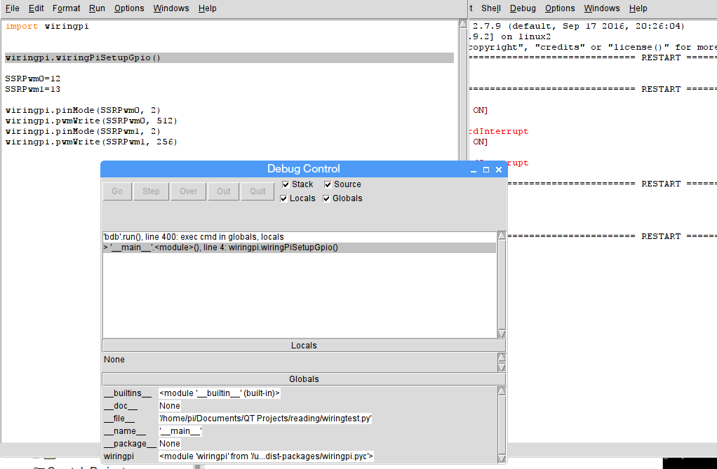

wiringpi hangs
Fri Mar 10, 2017 7:03 am
The debugger shows that the "import wiringpi" takes place, but the procedure initialize wiringpi.wiringPiSetup() hangs and nothing happens

can you post the complete code so that others can attempt to replicate the problem. Also how old is your Raspbian OS?
Various male/female 40- and 26-way GPIO header for sale here ( IDEAL FOR YOUR PiZero ):
https://www.raspberrypi.org/forums/viewtopic.php?f=93&t=147682#p971555
Danilk
Posts: 108
Joined: Wed Feb 01, 2017 7:47 pm
Location: Russia, St-Peterburg
Re: wiringpi hangs
Fri Mar 10, 2017 10:27 am
import wiringpi
wiringpi.wiringPiSetupGpio()
SSRPwm0=12
SSRPwm1=13
wiringpi.pinMode(SSRPwm0, 2)
wiringpi.pwmWrite(SSRPwm0, 512)
wiringpi.pinMode(SSRPwm1, 2)
wiringpi.pwmWrite(SSRPwm1, 256)
update/upgrade raspbian 09mar2017
