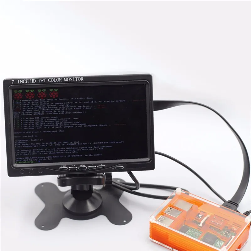

Sunfounder also has one good monitor for RPi, 7-inch but it has even lower power consumption (6W!)
Official AliExpress store:
https://www.aliexpress.com/store/produc ... 04716.html
Amazon:
https://www.amazon.com/Sunfounder-1024x ... B012ZRYDYY

600 vertical resolution isn't usually sufficient for GUI use. (Spent a lot of time using them on orig EE701s)
A lot of dialog boxes don't fit and you can't see OK/Cancel type buttons at the bottom of the boxes
(This is universal problem to may GUIs inc Windows - its not at all unique to Raspbian)
