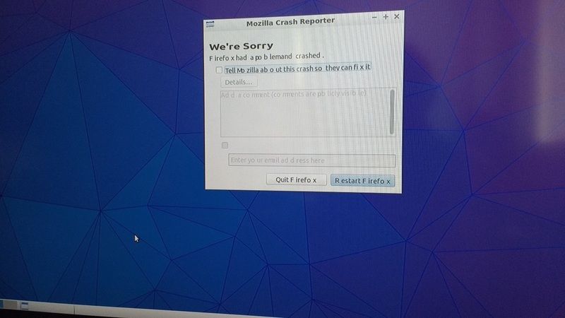

I just bought my first Raspberry Pi, but I'm unable to use it properly. I first installed Raspian from a Noobs pre-installed SD card. Unfortunately all the texts/icons soon became scrambled and every program I tried crashed.
I then formatted the SD card in Win 10 with SDFormatter, using full format (overwrite) and automatic size adjustment on. After this I installed Ubuntu mate and Lubuntu on the SD card using Win32DiskImager (with full formats in between), both were the RPi versions. After installation on the Pi I resized the file system with instructions from https://ubuntu-pi-flavour-maker.org/faq/. These distros also had the same kind of problems but additionally gave a memory warning. I'll attach pictures of the symptoms.
Curiously, I tried OpenELEC through Noobs and that seemed to work fine.
I had to improvise a bit with the power source because the vendor sent me one with the wrong kind of plug. Tried two different powers, a samsung galaxy tab charger and D-Link DUB-H4 powered usb hub, both are supposed to give out 5V and 2A. Power led was continuously lit on the Pi with both. As a display I had to use my 40 inch LG TV.
I don't have another SD card atm for additional testing. What do you think, is the problem with the SD card or the Pi itself?

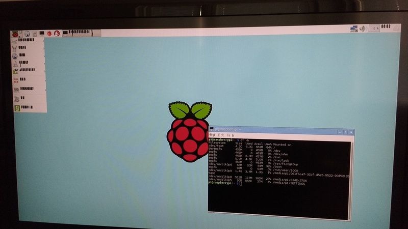

Well from two of those images you have no space left. try a larger sdcard, and/or expand the file system.
Size 4.2G with 3.3G used, and 661M available

Current OS installed is Lubuntu, and df -h shows 5,1 GB of available space for /dev/root. So that can't be it.
I think during that Raspian screenshot I had OpenELEC installed as well. Before that I had just Raspian installed so there was more space and still the same problems.

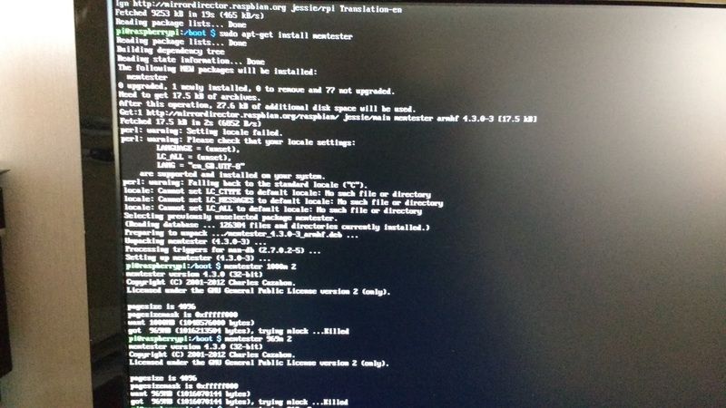

Today I then tried to run memtester and was unsuccessful, here's a screen from that:
Maybe I just didn't know how to use it properly. There was also some warnings about locales but don't know if those matter or not.

Your error with memtester is that you tried to get more memory then is available. You have to leave enough memory for the system.
Set gpu memory to 48, reboot, then;
memtester 700m 10
