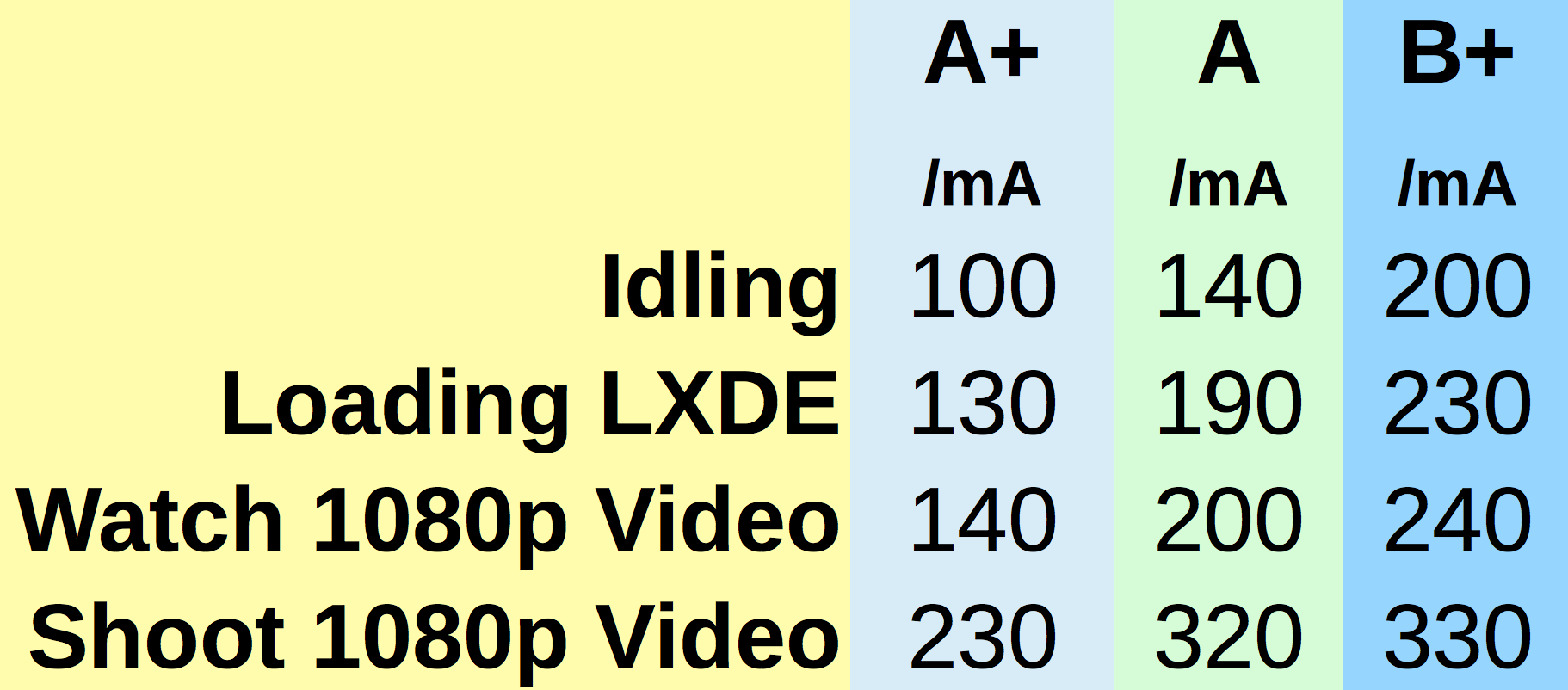

So. New model of Pi, the A+.
New round of power measurements (Vin was 5.2V)
I omitted the B as I spent all afternoon on this already. But for sake of comparison, at IDLE CLI the B drew 380 mA when measured against the B+ in the summer (although Vin was a little lower, so not a perfect comparison).
Bottom line. A+ uses about 70% of the power of the model A. Full review including video of the whole process here...
http://raspi.tv/2014/raspberry-pi-a-how ... es-it-need
