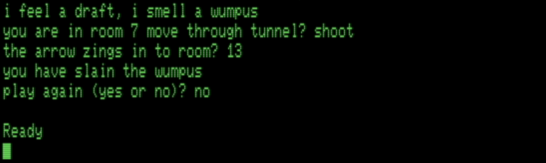

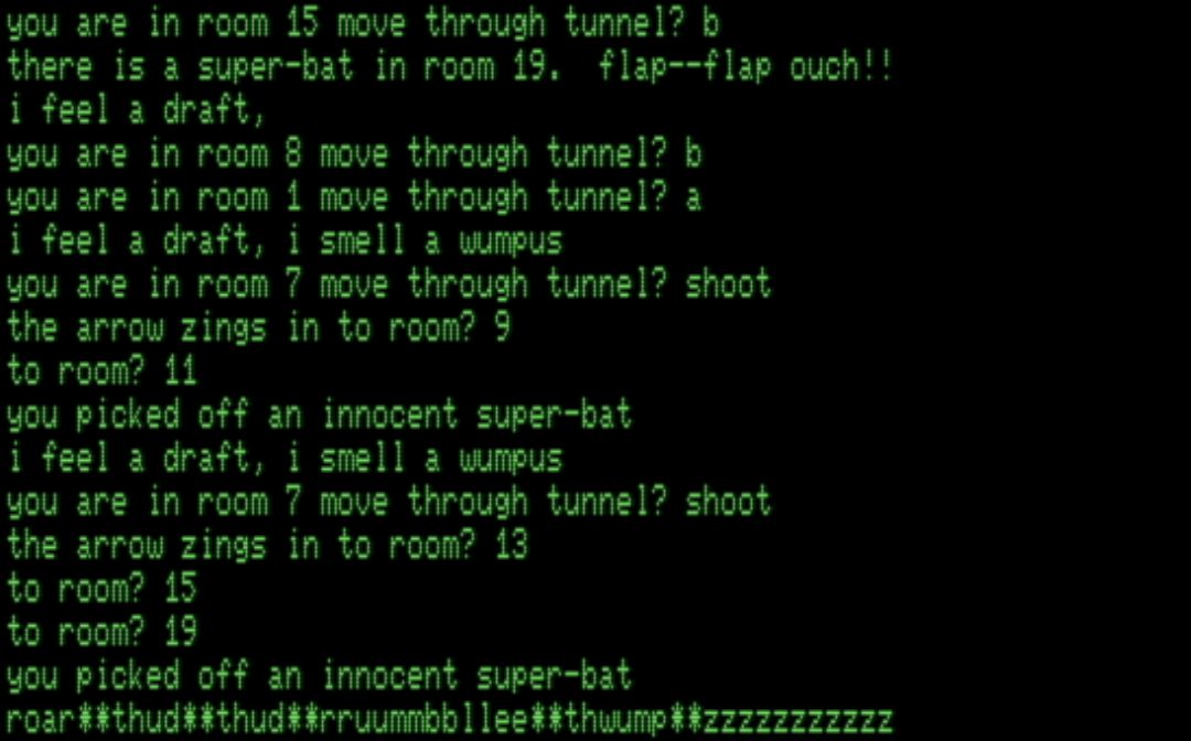

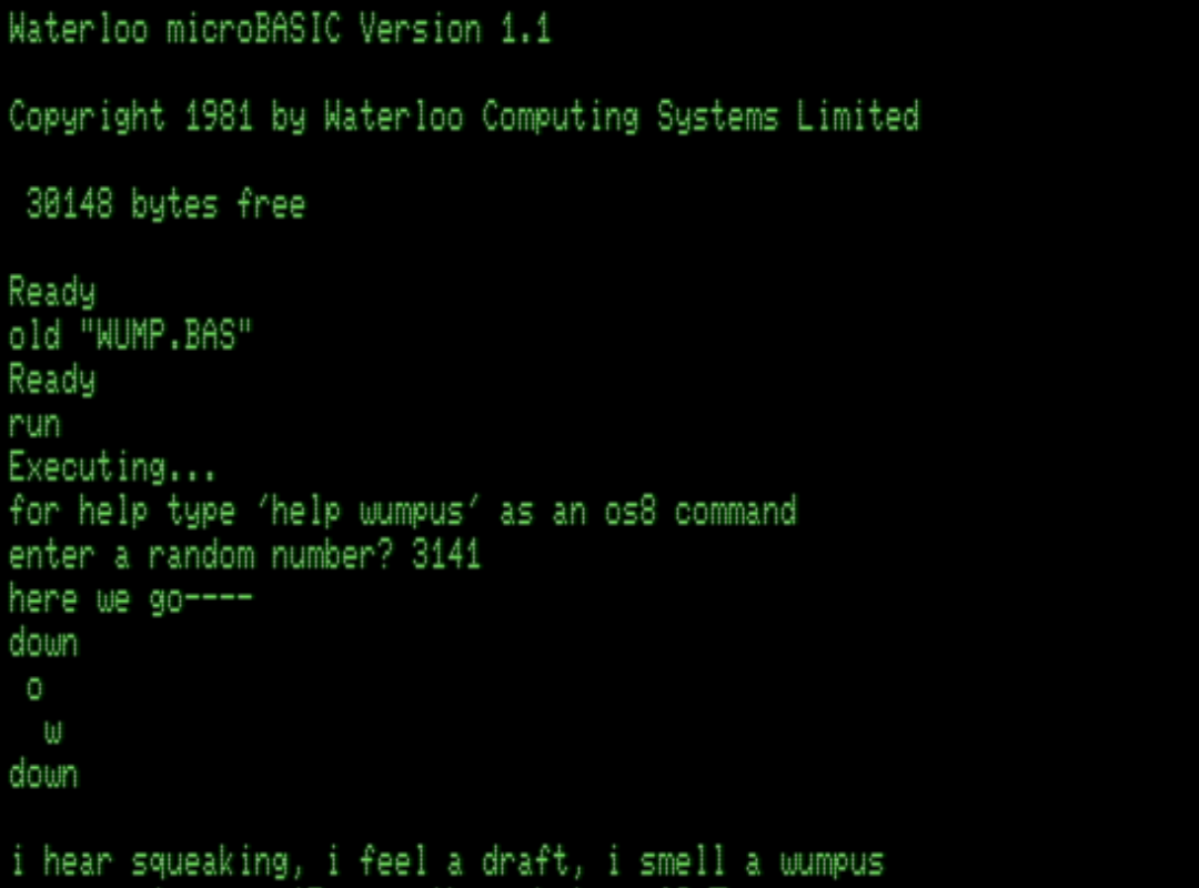

Here is a Hamiltonian graph created by the PDP-8 BASIC program translated to run on the SuperPET using Waterloo microBASIC.
A corresponding Wumpus hunt is
For reference the BASIC code for the SuperPET is
