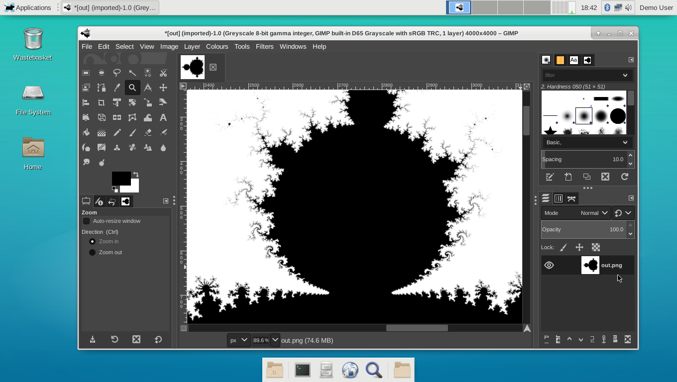

I've just posted a v1.3.1 release of my bootable 64-bit Gentoo image for the RPi3 (model B and B+) on GitHub (here, includes full download instructions).
A changelog from the prior release image (with upgrade instructions) may be viewed here, but in summary:
Here's a screenshot of the (vanilla) image in use, on an RPi3B+:
Have fun ^-^
Have fun ^-^

Re: Updated 64-bit Gentoo Image for RPi3 Released (now also for RPI3B+)
Gavinmc42,
so it looks as if using llvm:6 for this was a bit optimistic. I've just revbumped the pony-0.25.0 ebuild (so it now restricts the max LLVM slot to 5), built the package, and pushed the resulting binaries to the binhost (so as a result, sys-devel/llvm-5.0.2 is now available as a binary package too).
Built this way (i.e., under llvm:5), pony seems to compile the mandelbrot example ok. Steps to install and try it out for yourself:
This will update pony to 0.25.0-r1 via a binary, pulling in the (also binary) llvm-5.0.2 in the process (your 'other' LLVMs in slots 6 and 7 will not be deleted). Once done, download the mandelbrot test program:
And compile it:
Now you can try running it, with the default parameters, saving the output bitmap to out.dat:
Warning! That's a huge bitmap - if you try loading it (on your RPi3 anyhow) into a program like Ristretto, it'll create a full-colour-depth canvas to hold it (even though the original is only 1 bit per pixel), run out of memory, and quit. So, to convert it into something more viewable on your RPi3, rescale the image (and convert to a png), using imagemagick's convert tool (available as a binary package):
Conversion took longer than generation ^-^
You could of course build a smaller image in the first place (using e.g. the --width option to ./mandelbrot), but you may have wanted the original parameters for benchmarking etc., which is why I left it as above.
You can now view the resulting png, in e.g. gimp:
Screenshot on one of my testing boxes:
hth, sakaki
demouser@pi64 ~ $ sudo emaint sync --repo rpi3
demouser@pi64 ~ $ sudo emerge -avu dev-lang/pony
demouser@pi64 ~ $ mkdir mandelbrot && cd mandelbrot
demouser@pi64 ~/mandelbrot $ wget -c https://raw.githubusercontent.com/ponylang/ponyc/0.25.0/examples/mandelbrot/mandelbrot.pony
demouser@pi64 ~/mandelbrot $ ponyc
Building builtin -> /usr/lib/pony/0.25.0/packages/builtin
Building . -> /home/demouser/mandelbrot
Building cli -> /usr/lib/pony/0.25.0/packages/cli
Building collections -> /usr/lib/pony/0.25.0/packages/collections
Building ponytest -> /usr/lib/pony/0.25.0/packages/ponytest
Building time -> /usr/lib/pony/0.25.0/packages/time
Building collections/persistent -> /usr/lib/pony/0.25.0/packages/collections/persistent
Building random -> /usr/lib/pony/0.25.0/packages/random
Building buffered -> /usr/lib/pony/0.25.0/packages/buffered
Building files -> /usr/lib/pony/0.25.0/packages/files
Building term -> /usr/lib/pony/0.25.0/packages/term
Building promises -> /usr/lib/pony/0.25.0/packages/promises
Building strings -> /usr/lib/pony/0.25.0/packages/strings
Building signals -> /usr/lib/pony/0.25.0/packages/signals
Building capsicum -> /usr/lib/pony/0.25.0/packages/capsicum
Generating
Reachability
Selector painting
Data prototypes
Data types
Function prototypes
Functions
Descriptors
Optimising
Writing ./mandelbrot.o
Linking ./mandelbrot
demouser@pi64 ~/mandelbrot $ time ./mandelbrot --output=out.dat
real 0m17.197s
user 0m57.406s
sys 0m0.258s
demouser@pi64 ~/mandelbrot $ file out.dat
out.dat: Netpbm image data, size = 16000 x 16000, rawbits, bitmap
demouser@pi64 ~/mandelbrot $ sudo emerge -av virtual/imagemagick-tools
demouser@pi64 ~/mandelbrot $ time convert out.dat -resize 4000x4000 -depth 4 -colorspace Gray out.png
real 4m2.034s
user 1m31.596s
sys 0m15.878s
demouser@pi64 ~/mandelbrot $ gimp out.png &>/dev/null&
hth, sakaki
