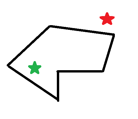

i start a proyect in the university but i have a big question (sry my language native no is english), i want check via GPS if the prototype is inside of the irregular area, image of example
i dont have problem with sensor, the big big dude is, how check is inside of the irregular perimeter, some idea for start ?
any idea is welcome
thanks for you time

yes, that use in open field, the points will be configured previusly (point = GPS position)
The general idea is use in a motorbike for big places, but the first step is detect the area

its a free proyect, the question how to pass the points to identify them as a "side"
Presumably you will represent the points defining the area as pairs of coordinates in the form returned by a GPS receiver. The standard used to be WGS84, but that may no longer be current.
I think I remember that if you know the coordinates of 2 points in a plane you can deduce the equation for the straight line passing through those points? The portion of that line between the 2 positions represents a side of your boundary shape.

I think the idea is to build a GPS surveying tool using Raspberry Pi. Green's theorem is surely the way to compute the area. Please read the whole Wikipedia article I linked to in my previous post.

Interesting article. While the length of the coastline may not be well defined, the area enclosed is. But now that I reread the question I see that it isn't a matter of finding the area, but whether a particular point is inside or outside the area. Again the answer can be determined by an integral over the perimeter, just a different one than for finding area.

The information at this link seems helpful
http://alienryderflex.com/polygon/

I want to thank you, I turned google looking for information but I did not succeed
It's just what I needed to put the idea, I want to tell you that this was the last problem for my project to work.
Really thank you ;)

There is a much simpler way to find if a point is inside or outside a polygon. Use the "winding number algorithm" See here: https://en.wikipedia.org/wiki/Point_in_polygon
