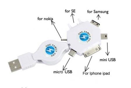

It doesn't have to be this one but I do have a cheap power bank which also comes with aversatile usb cable which is nice.. I can use it with my Xperia and my brother uses it sometimes and it works fine with his iPhone so the cable can do the job and the power bank itself is good.
I am still waiting on my RPi from ebay so I am not sure if it works with it but I am pretty sure it does since the first port runs at 5V 1A (max) and the second port at 5V 2.1A(max), the first one should be enough amperage for a RPi without much stuff plugged into the usb ports ...
It's your choice on the powerbank, if you go for a reliable and trust worthy brand one or a cheap one out of ebay, it does do job for me but its your choice..
