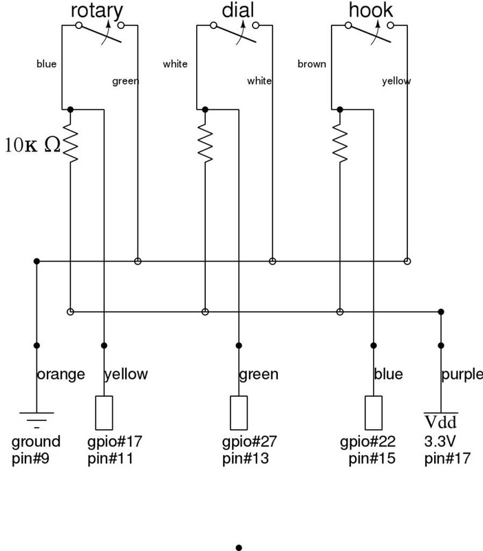

I'm working on connecting an old phone to the pi.
Found a good article on it here:
https://www.instructables.com/id/Raspbe ... ary-Phone/
Used their simple circuit like this...
Code examples with this are in nodejs.. and I'd rather use python...
I'm a little confused about the settings I need to use on the GPIO in relation to pull up resistors...
From that circuit , I have connected pull up resistors to the GPIO .. is that correct?
So when initialising the pins on the GPIO .. do I do this?
GPIO.setup(channel, GPIO.IN, pull_up_down=GPIO.PUD_UP)
Or do I leave out the pull_up_down bit?
Cos I've already go my own resistors??
Sorry now.. but I'm just not clear on what the pull_up_down part does? Does it enable internal resistors or something?
Thanks

Internal 50k resistors can be applied as pull-ups or pull-downs, and before anything else happens, most GPIOs have pull-downs by default.
If you leave them as-is, the internal 50k pull-downs together with your external 10k pull-ups give a potential divider, ending up with a pull to about 2.75v through about 8k - not ideal.
Applying GPIO.PUD_UP makes sure it's properly pulled up to 3.3v (through about 8k) whatever happens.

Ok,
So leave the code as-is with the GPIO.PUD_UP.
Great stuff.

A GPIO in/put with no internal or external
Resistance set, As a very high impedance
(Resistance) called Floating , it will not
Sink or source a signal, For it to work you
Must set it to to a working impedance
(resistance) to do this you set the Internal
Resistance or use a external 10k resistor..
To set the in/put to except a Logic 1/high
Connect the 10k resistor to the 0v Ground
To set the in/put to except a Logic 0/low
Connect the 10k resistor to to the 3.3v rail
0v rail-------(10K)-----(GPIO)
3.3vRail-----(10k)-----(GPIO)
