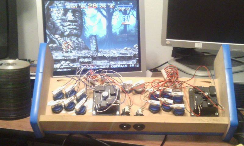

Will mame4all-pi work with 2 usb joystick cards? I use the zero delay one player usb cards on my PC mame builds, and I haven't tried 2 of them yet on the pi. (waiting for a shipment from china) I'm building 2 bartop arcade cabs for my Pies and I'd prefer them two players. I've used the xin mo on my last pc build, and I read that 2 players on one usb adapter wasn't working yet, but what about 2 adapters?

Anybody know if the pi can handle two joystick cards? I'm still waiting for my wiring to come from china (originally ordered sanwa connectors instead of happ, silly me!) so I can try it. I have a bunch of these cards and I would rather use them for two player cabs than have to buy another xin mo.

yes it works with 2 joystick cards... the big question I have is how does it determine which joystick is joystick 1? I set up the first joystick and tested it and it was fine, but when I plugged the second usb joystick in and rebooted it became joystick 1. Boo. I turned it off and switched the usb connectors (they're in a hub) and switched back on and the "wrong" joystick is still called joystick 1. Is there a way to set the correct usb to always be joystick 1?

There probably is, but it might require some complex "udev" rules. If its two identical joystick-devices it gets even more tricky.
The output from "lsusb -v" with both joysticks inserted might give some clue to how to solve it.
(its pretty long, use pastebin or something)
