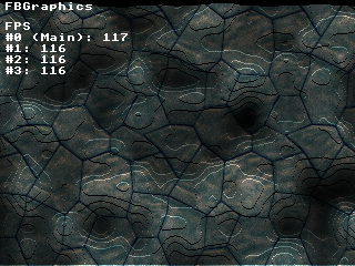

Here is a small screenshot of the full example with graphics code running on 3 cores on a Raspberry PI 3B (320x240) :
This example feature an unoptimized fullscreen per pixels perlin noise with texture mapping and scrolling.
Fullscreen texture-mapped and animated tunnel made of 40800 2px rectangles with motion blur (unoptimized)
