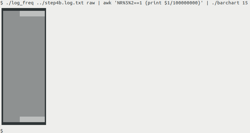

CPU frequency was 1.5GHz the whole time of compilation:
Reduction in number of data lines from 48 to 20 as well as scaling (0-1500000000 to 0-15) was done utilizing awk:
https://github.com/Hermann-SW/temp_freq ... nd-scaling
$ ./log_freq ../step4b.log.txt raw | awk 'NR%5%2==1 {print $1/100000000}' | ./barchart 15
