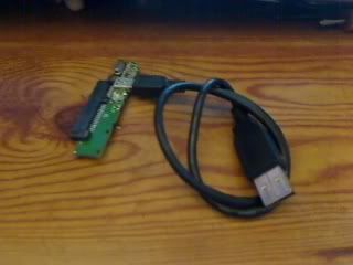

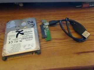

I stole the drive out of my Western Digital drive my passport, and kept the controller and cable for various uses for SATA 2.5 drives.[IMG]http://img.photobucket.com/albums/v258/ ... cture8.jpg[/IMG]
[IMG]http://img.photobucket.com/albums/v258/ ... cture7.jpg[/IMG]
Yes I know the drive is a PATA, the drive is there for a size comparison.
I have used this controller/cable combo on 320Gb and down to 120Gb on multiple brands Samsung, Seagate, Western Digital, and Hitachi.
Original drive size was 250Gb
