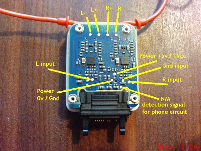

If you want cheap speakers the MPS-60 doesn't come any cheaper at 2 quid + free postage - http://www.amazon.co.uk/Sony-Ericsson-M ... 000FIBMPE/
These speakers are designed to run off Sony Ericsson phones, however they're easy to mod to use USB power and an external headphone jack.
Despite their small size they can pack some decent bass and while not not exactly earth shattering loud they work well with the Pi's analogue output.
There are plenty of online tutorials for modifying the MPS-60 but you're going to need some soldering skills the amplifier board is quite small and fiddly.
Fortunately there are test pads exposed on the reverse side which you can (ab)use to solder on additional wires.
The pinout for the test pads are as follows:
As for technical specifications the amplifier has 2 x TS4994 ICs they provide up to 1 watt RMS per channel at 8 ohms in BTL mode, power supply 2.5 - 5.5v
It should be possible to drive the amp using the Pi's USB port, or GPIO +5v supply rail but you must hook this up before the Pi is switched on and not after.

can someone tell me if i can connect 5v input somewhere else instead of the extra pin and the main? (like in one end of a resistor)
