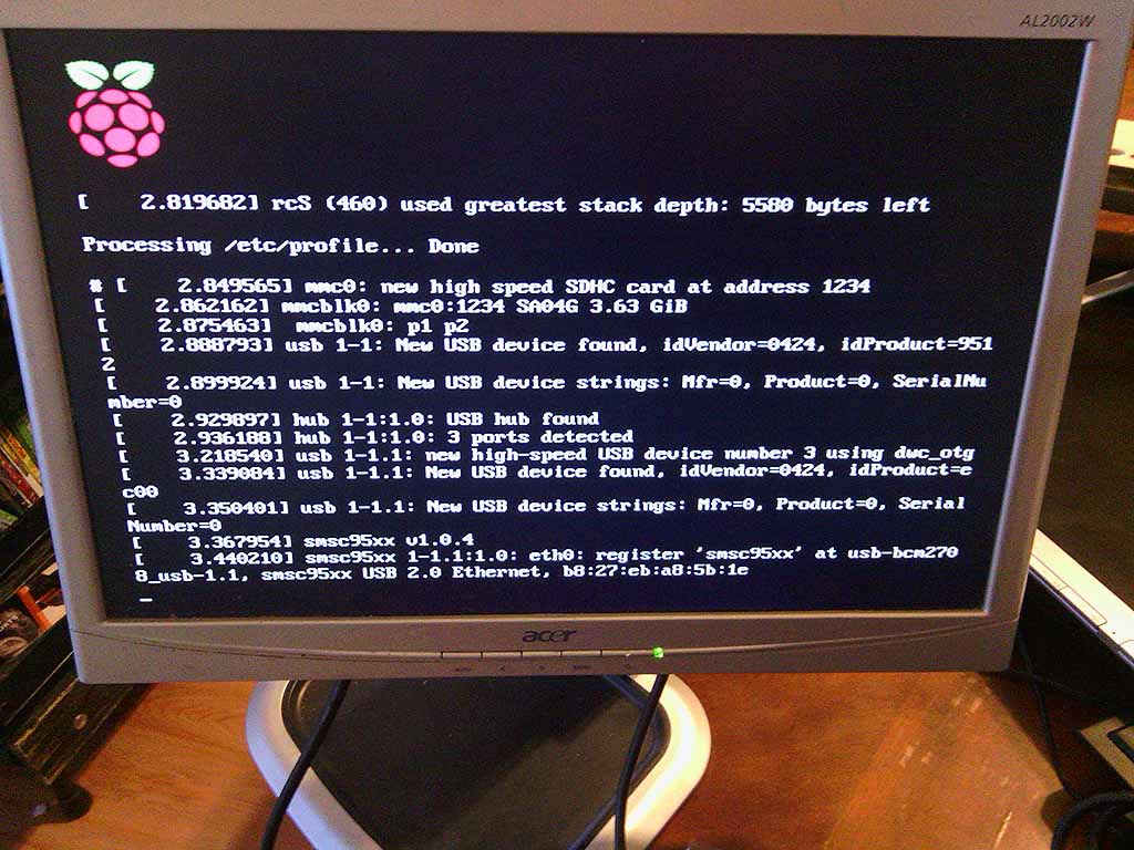

I got a pi when they first came out and I loved it (I'm building an arcade cab with it running pimame) so a few months ago I bought a 512mb one (used) on ebay. When I received it, I took it out of the box, looked at the nifty new mounting holes, then, being busy with another project, put it back in the box and stuck it on a shelf next to the other one to wait until I could get back to it.
Ok, so this week my wife tells me to build 4 bartop arcade cabs this week so she doesn't have to see my hoarder stash of computer parts any more. I pull the "new" pie out of the box...and it doesn't work. It boots to this far:
(download the image you can see it full size)
Anything I can do to resurrect it? If no, anybody want a deadish pi?

Have you tried re-imaging your sdcard? if it boots that far, I have a hard time believing it is the hardware.

I've tried several SD cards, and several distros on each one. All of them boot fine on the other Pi.

Is there any response when you press the Enter key at that point?

measure the voltage between TP1 and TP2, perhaps its below the 4.75V the Ethernet/Hub chip needs to operate.
This chip, when turned on, suddenly increases the power demand. Its one of the biggest power users of the PI.
Could be caused by a flaky power-supply/ microUSB cable / polyfuse.
Especially the polyfuse F3 could have had some abuse from the previous owner, normally it will recover in time, but if it has "blown" many times it will never completely recover, which makes it liable to "trip" again, or cause a big voltage drop.
Alternatively the PI could have had a bang that dislocated the quartz sliver in the ethernet chips crystal, stopping the crystal from oscillating. sometimes heating the crystal by re-solderings it helps.

I had similar issues with my Pi when it was new. A mate had given me his Pi to set up as he was far too lazy to learn how to do it himself. I set his up beautifully and imaged the SD card to use in mine, as I was so impressed with his. His booted perfectly on either SD card and mine did something very similar to that screenshot. In the end I swapped the power cables, in desperation, and bingo mine worked. He was using a Samsung lead/PSU from a Samsung phone and I was using some 99p lead and a 99p PSU from eBay. I have since started using an HTC branded lead and an iSound dual USB PSU.

I switched power cords and it gets to
"input: USB HID v1.10 Device [novatek USB Keyboard] on usb-bcm2708_usb-1.3/input1"
If I hit a key I get a "#"
If I type anything and hit enter I get
-/bin/sh: _(whatever I type)__ : not found
on the lights I have a solid yellow, blinking green, solid green, solid red. Does that mean anything?

if I type ls I get:
README.md dev lib sbin tmp bin etc mnt sd usr boot init proc sys var
and the # prompt. I know almost nothing about linux, so I'm stuck there. This particular sd card is pimame and on my other pi it goes right to the pimame menu

You're running in "Safe Mode".
I don't know why this is happening to some people just recently. It may be that a software update caused it.
Safe Mode is an emergency recovery system that is normally activated if pin 6 of P1 is connected to 0V/GND when the Pi is switched on. I'm guessing that you haven't got anything connected to those pins, so it may be a bug.
All you need to do to stop it happening is add the line
avoid_safe_mode=1
in your config.txt file. Then your Pi should boot normally.
[edit] When you are in safe mode, you can remove power from your Pi without needing to shut down cleanly or anything - nothing is using the SD card at that point - the OS and recovery filesystem is all in RAM instead.

It worked! A big round warm of applause to the guru...
