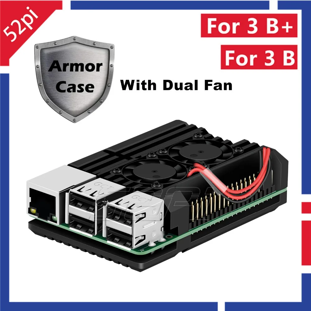

You can be sure, that you have no problems with heat anymore with this case :D
Note: "52pi" is original designer of this armor case, rest are either selling stock from 52pi (package has guide with 52pi logo on it) or selling copy version, with possible of wrong aligned of screws, thermal tapes wrong thickness or other quality problems.

I wonder how much noise that makes?

I've heard some who got defect cases (who knows, maybe even copy cases?) noises were somewhat high, but normally they should not do much noise at all, if you are used on computer fans, then these are almost silent.

I have one, but wont be using the GPIO header's 5V and GND pins to power the fans ( I never power my fan cooled RPi's from the GPIO header's 5v and ground pins)
Opened it already but the RPi3B I was planning to installed it to ran into a bit of a problem. The 26x26x6 heatsink was glued firmly to the SOC, that's when I remembered I used thermal adhesive to mount the heatsink.
Might test the fans first if those are "noisy". If it is noisy then I need to "silence" it first. Then install into my incoming RPi3B...
.. and install my spare DAC on top of it, giving a lower profile than the one now I have on setup

You could also take off fans out of the case, it would still be good as it's open case.
It just leaves quite hollow place on the upper plate (looks ugly), anyway then it would be fanless.

It looks like this. Already enough ventilation + 8 small extra holes (which were for screws)

Anyway, IMO those fans are not much needed on that case, reason why I took them off. As you can see, compared to rest aluminum cases which are solid, this one is open case, so no problem with ventilation, and also compared to solid aluminum case, open case has noticeable reliable WiFi connection :)
And you can replace stock 3M thermal tapes (0.6 W/m.K), which comes with the case, with thermal paste of course (for obvious thermal boost), or with improved thermal tapes 0.3mm thickness, such as Akasa thermal tape (0.9 W/m.K), but don't use thermal pads (which usually starts from 0.5mm, it makes impossible to get case closed with screws, as they won't be able to go all way)
