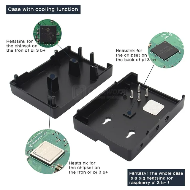

This case will keep your 3B+ model cool, thermal tape / pads are recommended to use with case, thickness of 0.15mm somewhat thin, bad to none contact (0.25 - 0.5mm takes contact, differences comes with pressure), I got 2 of these cases just 2 days ago (bought from banggood), used Akasa thermal tape (0.3mm, good contacts, tough bonding) with one case, other still unused.
No need worry either of 3 components to get overheated even during extreme usage.
https://m.aliexpress.com/item/32882759821.html
