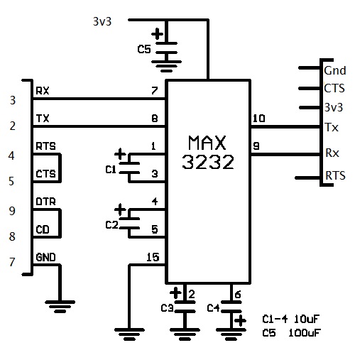

Try a search on the phrase
Ultra Compact RS232 to TTL Converter with Male DB9
and you will probably want some conection leads to connect it to the header.

If you buy a converter, make sure it uses 3V3, not 5V0. Getting that wrong will probably damage your Pi.
