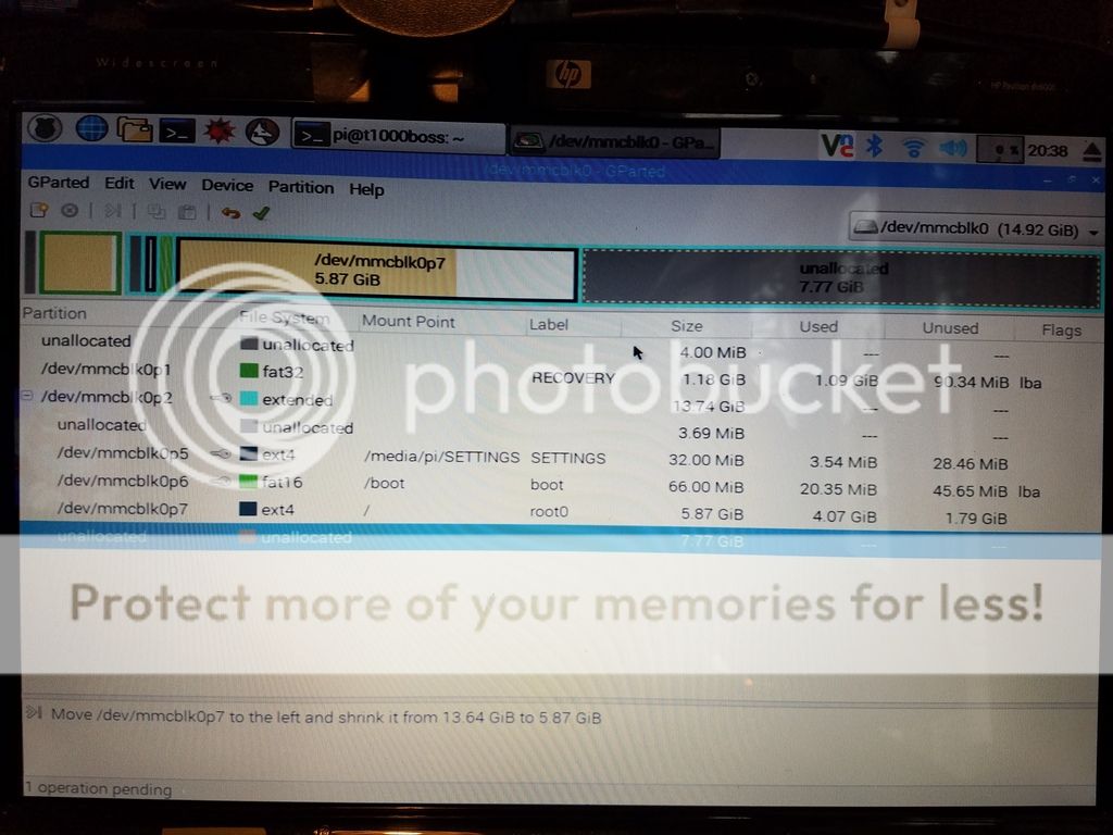

I have a Pi running on a 16gb card and I like to back up entire images to Dropbox... This is what I seen in Gparted - what are the correct things to click so this would fit on an 8GB sd card? I get a warning if I try to shrink the big partition root0. (Ideally it'd be a bit smaller than 8GB- I learned the hard way that an image of an 8GB sd card won't always fit on other cards. I'd like to not have to worry about that.)

As regards the initial problem...gparted will change the partition sizes, but the usual backup tools (win32diskimager and dd) copy the entire contents of the SD card, whether or not those blocks are part of a file system or not. It's the difference between a logical copy and a physical copy. You need a backup process that recognizes and uses partition allocation information.

Are you trying to shrink a partition that is in use? I mean you appear to be using gparted on pi itself.
If so, you can get around this by not using the same pi. Shut it down and take out the card. Then use a linux laptop, another pi (or the same pi with another raspian card) or live dvd/usb boot a Windows laptop temporarily with gparted live disk. Insert the raspbian card. Then the partitions will be offline and unmounted. Shrink said partition and copy-paste all of them on a smaller card or whereever you want. Gparted allows you to copy paste entire partitions. Then full physical back up that smaller card to your cloud as an image file that you can write with windows. Or even simpler, just copy the partitions and later use gparted again to copy paste them back without having to create img file

tpylkko wrote:Are you trying to shrink a partition that is in use? I mean you appear to be using gparted on pi itself.
Ahh..may give that a shot. (But nope - you were looking at a shot of a card plugged into USB - operating off of another Pi.

by tpylkko
Ok. My bad. What error is it that you get then?
