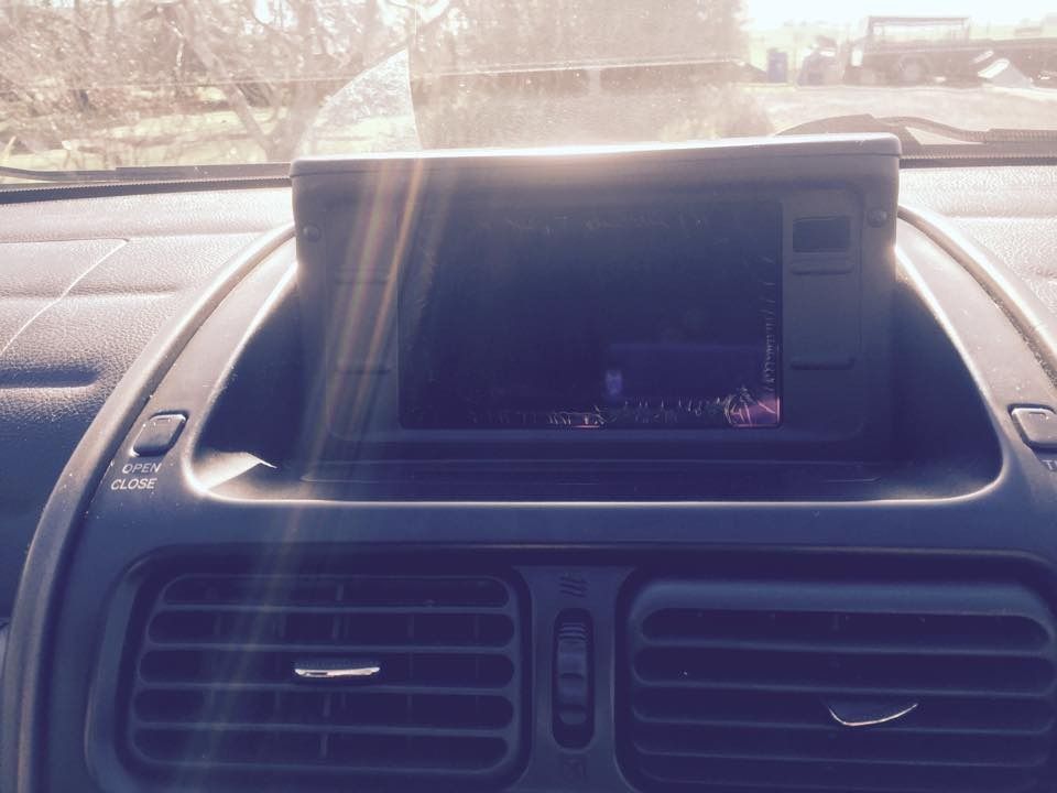

So i have a 1999 altezza and it has a factory gps unit in it but of course it only works in japan and i live in new zealand. i thought it would be a cool idea to install pi and replace my gps. Now my plan was to get a screen (5.5' i believe it is) and a r-pi and wire it all up so it will power on when the car starts and turn off when the car is off. I was all so going to wire up two usb ports on each side so people can charger there phone or plug usbs into the pi to play there music. I haven't done this kind of stuff in a few years and jsut wanted to know if it will be ahrd job to do or anything worth adding or changing ? or just go the simple way and install a gps/ tablet unit.Image
