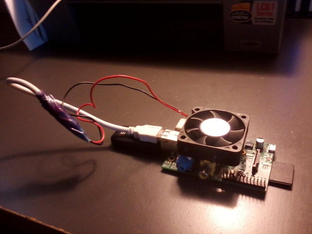

Ive played it safe and posting this in the off topic, What are your guys opinion on this? I found a USB light at the 99 cent store, and my dad found a motherboard with a fan. What are your thoughts? Image
I know its not good looking, but it gets the job done!

Very nice. Probably want to put the red and black wires together. The raspberry pi doesn't need a fan by default. Wondering by you built one.

kusti8 wrote:Very nice. Probably want to put the red and black wires together. The raspberry pi doesn't need a fan by default. Wondering by you built one.
Because of emulation, Im pushing it and trying to overclock it to run 64-bit (N64)
all the way to 8-bit (NES) alot faster

Even with overclocking you shouldn't need a fan, unless perhaps you have done one of the voltage mods and are pushing it close to breaking point.
Just keep an eye on the temperature with vcgencmd measure_temp. If you see it go anywhere near 80°C, then you might benefit from one, but the CPU is set to slow down if it reaches 85°C until it has cooled down a bit.

I did a similar setup on mine, i'm using a 1 inch fan though. I used an old iphone cord that the kids pulled the end off of soldered the leads together, and plugged it into an iphone usb carger. Dropped my temp from 60C to 34C. I know i don't need the fan, but it's a lead in to another project for me to tinker with. Now i have an excuse to see if i can make a fan controller and regulate the temp at 50C, just for the heck of it.
