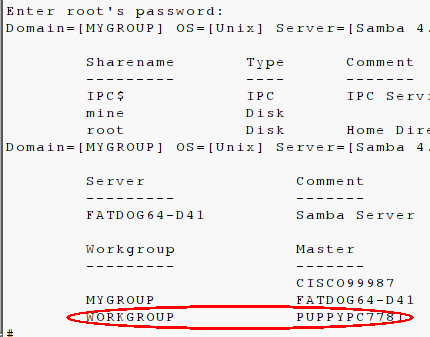

To make a connection to a Windows or Linux computer using an ethernet cable is simple using Fatdog_connect
Network > Fatdog Connect
Fist you must fill in the address of the computer you want to connect to
In windows console type 'ipconfi /all'
In linux computer terminal type 'ifconfig'
Note the difference in spelling!!
________________________________________
Next you need the share name.
If you have samba installed then click the button 'Share list'
(See image)
In this example two shares are available from the same computer.
Choose the one you want.
Click on 'Connect' and you will be asked a password.
It is the Samba password.
The folder corresponding to the share will show in the file manager.
