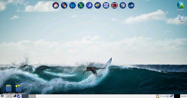

Here it is with the interface improved with wbar.
