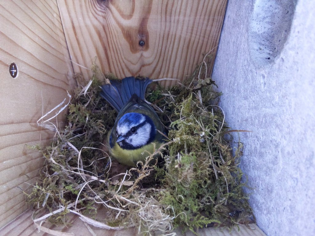

Hi all,
I am thinking of ordering the HQ camera with the 6mm wide angle lens (or possibly the IR cut version of same, from Arducam). I will be using the camera in a bird nesting box, and have had success over the last few years with both v1 and v2 cameras. One issue with nest boxes is that the space is very confined, and typically the camera is only about 15cm from the "action". The minimum object distance for the 6mm lens is quoted at 0.2m, although in my experience these values are often a little conservative, so it would be really useful for me if someone who already has this camera and lens could confirm a real-world minimum focus distance. I think I could work with 15cm, although even a bit less would be great. The other challenge, especially when focusing close, and with a large aperture setting, is the depth of field - the larger the better. A major issue when setting up these nest boxes is that you have one chance to set focus, aperture etc and then you effectively have to leave it for several months, so a lens that can keep as much as possible in focus, whilst still working well in low light, would be ideal.
Alternatively, if the required MOD with the stock 6mm lens is not going to be achievable, does anyone have suggestions for an alternative lens to fit the HQ camera? The picture below is from this year's nest, using a v2 camera. The FOV is about right for this box, at just over 60 degrees horizontal, so a similar lens would be ideal (slightly wider also acceptable).
thanks!

I have both HQ cameras and I remember doing some close-up testing. With both HQ models, I had managed to get a good focus at 15 cm and still much less, which is adequate for a nesting box. By the way, I have a lot of Raspberry cameras in several nesting boxes but I never had the idea to put a HQ camera because it does not come in a NoIr model. So, all my nesting box cameras are NoIr and equipped with infrared lights so as not to scare the birds and to be able to observe them at night (as I am doing now with a nest of spotted screech-owls). I can always remove the IR filter from the HQ camera but at the price it costs, I'll wait until they come out with a NoIr HQ model. In the meantime, the V2 cameras do a very good job. Go visit this page:

Thanks you so much! This is exactly the information I was looking for, and indeed it does seem as if the 20cm specified minimum focus distance is very conservative! How are you finding depth of field at close focus? Do you think it might be feasible, for example, to keep the range 12-20cm in focus? That would be ideal.

Thank you all. That depth of field calculator is very useful, and suggests that the stock 6mm lens is not going to be too useful for me - I will be limited to a 1cm field at a distance of 15cm and an aperture setting of F1.2. Strange, because I had the impression that the aperture was variable, but looking again at the spec sheet that doesn't appear to be the case. In which case, what does the "open/close" control on the lens actually do? (as distinct from what looks like the focus control). A similar length lens capable of an aperture setting of F8 or F16 should work well, although of course low light operation will be compromised.
