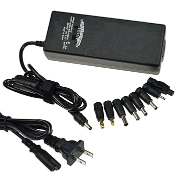

Something with multiple connectors like this?

Thanks, Doug, but those are notoriously shoddy units for field or mission critical work. I'd prefer to build my own cables; then I know what I have.
Besides, I'm drawing from a 12v source, not 110v, so purchase of a transformer and a half dozen extra (useless) connectors to replace a quality $0.80 barrel connector is a bit overkill on the buy and underkill on the outcome. ;-)
Can you assist with specs for the actual barrel connector only?

rluci wrote:Thanks, Doug, but those are notoriously shoddy units for field or mission critical work. I'd prefer to build my own cables; then I know what I have.
