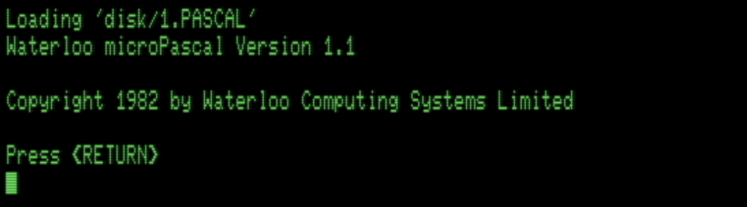

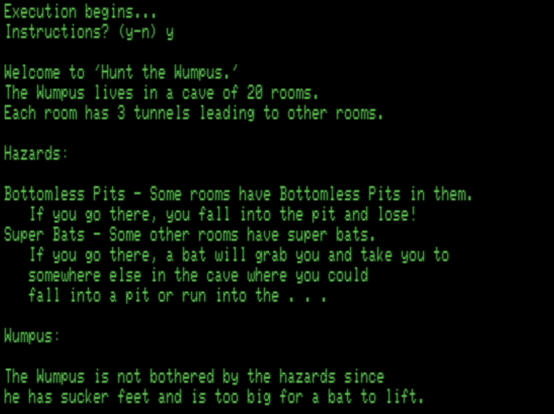

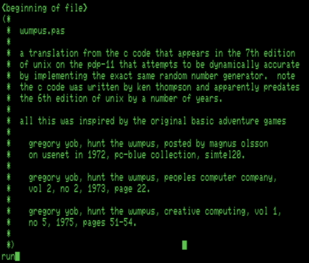

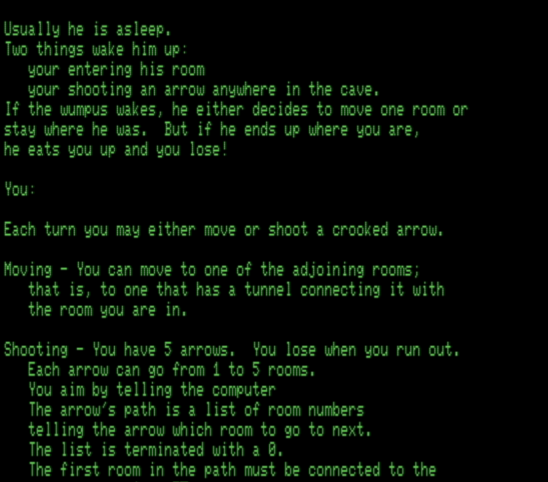

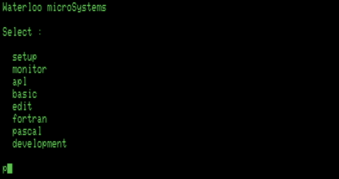

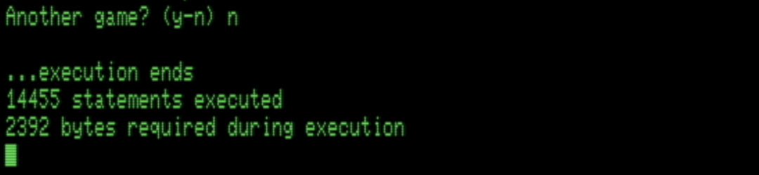

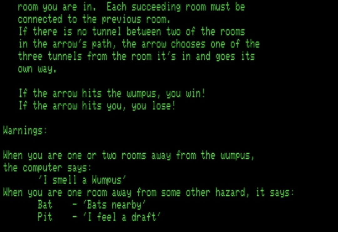

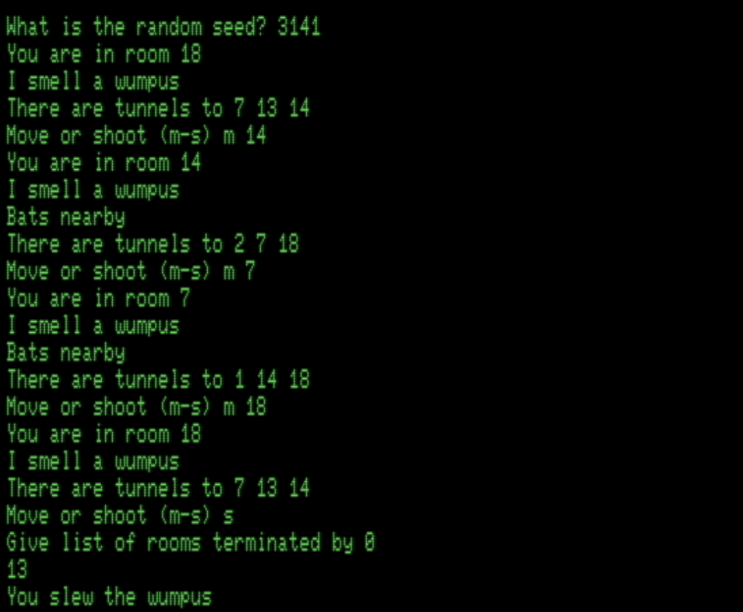

To get started, here is a screen dump of my microPascal port of Ken's version of Hunt the Wumpus running on the SuperPET using VICE with a Pi 4B
just in time for Fido's birthday.
Subsequent posts will describe what needed to be done to compile and install the latest version of VICE on the Pi and compare this with what needed to be done to port Ken's C code to microPascal for the SuperPET. After that a version of Hunt the Wumpus written in Rust for the Raspberry Pi will form the basis to further understand the relative contexts of these two historically significant educational computing platforms.
Then, moving to a modern setting--unless the thread is closed by then--I plan to consider the development of an artificial intelligence that uses a convolutional neural network to learn how to reliably win while playing Hunt the Wumpus. The question here is whether today's Raspberry Pi constitutes a sufficient platform for a student to learn about such computer-science techniques.
As in the other threads, help, feedback and additions to these topics would be very much appreciated.

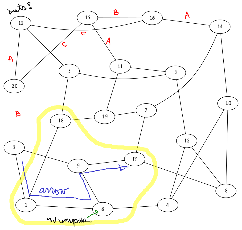

Idle musing. How many topographically unique graphs or caves can be formed with 20 vertices, each connected to exactly 3 neighbors, without overlapping edges, in three dimensional space?

Idle musing. How many topographically unique graphs or caves can be formed with 20 vertices, each connected to exactly 3 neighbors, without overlapping edges, in a three dimensional space?
An answer to how many random mazes are possible was partially discussed and referenced in
viewtopic.php?p=1714376#p1714376
From a deep-learning AI point of view, randomly generated mazes seem much more challenging than a torus or the original dodecahedron--there is much more hidden state to be reconstructed.
It is not clear how a deep learning neural network would cope with that directly. Humans tend to look at the scroll-back buffer or draw a map, so an AI should probably have access to some sort of record of past moves in order to make the next. Note that the use of Hunt the Wumpus for AI student projects was also touched on in the above-linked thread.
I would emphasize that Ken's random graphs, the fact that you can smell the Wumpus from two vertices away and the greater tendency of the Wumpus to not eat you you make the Unix version of Hunt the Wumpus noticeably different than the BASIC program by Gregory Yob. Although the original game has been translated into many languages, the Unix variant has not. Even if the Unix version had been widely translated, it would still be necessary to write more programs to understand the suitability of each educational computer for teaching and learning. This is because with programming, as with as most other measurable skills, the way forward is to learn by doing.

Here is a sample game of PDP-8 Hunt the Wumpus played using BBC BASIC.
$ ./bbcbasic
BBC BASIC for Linux Console v0.28
(C) Copyright R. T. Russell, 2020
>LOAD "WUMP.BAS"
>RUN
FOR HELP TYPE 'HELP WUMPUS' AS AN OS8 COMMAND
ENTER A RANDOM NUMBER? 3141
HERE WE GO----
DOWN
 O
  W
DOWN
I HEAR SQUEAKING,
YOU ARE IN ROOM 16 MOVE THROUGH TUNNEL? A
I HEAR SQUEAKING, I FEEL A DRAFT,
YOU ARE IN ROOM 14 MOVE THROUGH TUNNEL? A
I HEAR SQUEAKING,
YOU ARE IN ROOM 16 MOVE THROUGH TUNNEL? B
YOU ARE IN ROOM 15 MOVE THROUGH TUNNEL? B
I HEAR SQUEAKING,
YOU ARE IN ROOM 15 MOVE THROUGH TUNNEL? A
I FEEL A DRAFT,
YOU ARE IN ROOM 11 MOVE THROUGH TUNNEL? A
YOU ARE IN ROOM 15 MOVE THROUGH TUNNEL? C
I HEAR SQUEAKING,
YOU ARE IN ROOM 20 MOVE THROUGH TUNNEL? LIGHTS ON
I SEE THAT TUNNELS A B AND C LEAD TO ROOMS 13 3 AND 15 RESPECTIVELY
I HEAR SQUEAKING,
YOU ARE IN ROOM 20 MOVE THROUGH TUNNEL? LIGHTS OFF
I HEAR SQUEAKING,
YOU ARE IN ROOM 20 MOVE THROUGH TUNNEL? B
I SMELL A WUMPUS
YOU ARE IN ROOM 3 MOVE THROUGH TUNNEL? SHOOT
THE ARROW ZINGS IN TO ROOM? 1
TO ROOM? 6
YOU HAVE SLAIN THE WUMPUS
PLAY AGAIN (YES OR NO)? NO
STOP at line 1420
While playing the game I marked up a graph previously generated by the MAP command in a barely legible way using xournal with a mouse and then converted it to PNG format using the PrtScr button.
It appears the random graph is generated in such a way that the edges may be labeled A, B and C and that each vertex in the graph has exactly one edge of each type connecting to it. My understanding is the random graphs created by Ken's algorithm do not necessarily have this property. On the other hand, from what I can tell, it is possible the graphs made by the PDP-8 program do not all admit a Hamiltonian path that visits each vertex only once. Which makes for a better game is difficult to determine.

It occured to me that any computer used for teaching must also support legacy programming languages, not only because the old has value, but because textbooks and other educational materials are updated more slower than technology and not all teachers want or have the time to keep up with every new innovation. In 1982 this meant that the SuperPET needed to run BASIC programs while today the Pi needs to run Python.
Before comparing the legacy capabilities of these two computing platforms, it seems reasonable to present the finished form of Hunt the Wumpus written in Waterloo microPascal with a student-level understanding of all the latest advances in programming technology circa 1982.
 *  wumpus.pas
 *  a translation from the c code that appears in the 7th edition
 *  of unix on the pdp-11 that attempts to be dynamically accurate
 *  by implementing the exact same random number generator.  note
 *  the c code was written by ken thompson and apparently predates
 *  the 6th edition of unix by a number of years.
 *  all this was inspired by the original basic adventure games
 *    gregory yob, hunt the wumpus, posted by magnus olsson
 *    on usenet in 1972, pc-blue collection, simtel20.
 *    gregory yob, hunt the wumpus, people's computer company,
 *    vol 2, no 2, 1973, page 22.
 *    gregory yob, hunt the wumpus, creative computing, vol 1,
 *    no 5, 1975, pages 51-54.

function doagain:boolean;
var i,j,k,p:integer;
    c:char;
    bump:boolean;
begin
    doagain:=true;
    repeat
        bump:=true;
        c:=rline(20,'Move or shoot (m-s)      ');
        if c='m' then begin
            if tchar=chr(10) then begin
                i:=rin(12,'which room?              ')
            end else begin
                i:=rin(0,blank)
            end;
            for j:=1 to ntunn do begin
                if i=rms[loc][j] then bump:=false
            end;
            if bump then begin
                writeln('you hit the wall')
            end else begin
                goroom(i)
            end
        end else if c='s' then begin
                writeln('Give list of rooms terminated by 0')
            end;
            p:=loc; i:=1;
            j:=rin(0,blank);
            while (j>0) and (i<=5) do begin
                repeat
                for k:=1 to ntunn do begin
                        if j=rms[p][k] then begin
                            p:=j; bump:=false
                        end
                    end;
                    if bump then j:=rnum(nroom);
                until not bump;
                if j=loc then begin
                    writeln('You shot yourself');
                    j:=0; doagain:=false
                end else if j=wloc then begin
                    writeln('You slew the wumpus');
                end else begin
                    i:=i+1;
                    j:=rin(0,blank);
                    bump:=true
                end
            end;
            bump:=false; arrow:=arrow-1;
            if arrow=0 then begin
                writeln('That was you last shot');
                doagain:=false
            end
        end else if c='g' then begin
            rmsgraph
        end
    until not bump
end;
function near(t:things):boolean;
var j:integer;
begin
    near:=false;
        if occupied(rms[loc][j])=t then near:=true
    end
end;
function smell:boolean;
var i,j,k:integer;
begin
    smell:=false;
        k:=rms[loc][j];
        if wloc=k then smell:=true;
        for i:=1 to ntunn do begin
            if wloc=rms[k][i] then smell:=true
        end
    end
end;
 *  main loop of the game
function status:boolean;
var alive,moved:boolean;
    i:integer;
begin
    alive:=true;
    repeat
        moved:=false;
        writeln('You are in room ',loc:1);
        if occupied(loc)=epit then begin
            writeln('You fell into a pit');
            alive:=false;
        end else if loc=wloc then begin
            writeln('You were eaten by the wumpus');
            alive:=false;
        end else if occupied(loc)=ebat then begin
            writeln('Theres a bat in your room');
            loc:=rnum(nroom);
            moved:=true;
        end
    until not moved;
    if alive then begin
        if smell then writeln('I smell a wumpus');
        if near(ebat) then writeln('Bats nearby');
        if near(epit) then writeln('I feel a draft');
        write('There are tunnels to');
            write(' ',rms[loc][i]:1)
        end;
        writeln;
    end;
    status:=alive
end;
procedure help;
begin
    writeln;
    writeln('Welcome to ''Hunt the Wumpus.''');
    writeln('The Wumpus lives in a cave of ',nroom:1,' rooms.');
    writeln('Each room has ',ntunn:1,' tunnels leading to other rooms.');
    writeln;
    writeln('Hazards:');
    writeln;
    writeln('Bottomless Pits - Some rooms have Bottomless Pits in them.');
    writeln('   If you go there, you fall into the pit and lose!');
    writeln('Super Bats - Some other rooms have super bats.');
    writeln('   If you go there, a bat will grab you and take you to');
    writeln('   somewhere else in the cave where you could');
    writeln('   fall into a pit or run into the . . .');
    writeln;
    writeln('Wumpus:');
    writeln;
    writeln('The Wumpus is not bothered by the hazards since');
    writeln('he has sucker feet and is too big for a bat to lift.');
    writeln;
    writeln('Usually he is asleep.');
    writeln('Two things wake him up:');
    writeln('   your entering his room');
    writeln('   your shooting an arrow anywhere in the cave.');
    writeln('If the wumpus wakes, he either decides to move one room or');
    writeln('stay where he was.  But if he ends up where you are,');
    writeln('he eats you up and you lose!');
    writeln;
    writeln('You:');
    writeln;
    writeln('Each turn you may either move or shoot a crooked arrow.');
    writeln;
    writeln('Moving - You can move to one of the adjoining rooms;');
    writeln('   that is, to one that has a tunnel connecting it with');
    writeln('   the room you are in.');
    writeln;
    writeln('Shooting - You have 5 arrows.  You lose when you run out.');
    writeln('   Each arrow can go from 1 to 5 rooms.');
    writeln('   You aim by telling the computer');
    writeln('   The arrow''s path is a list of room numbers');
    writeln('   telling the arrow which room to go to next.');
    writeln('   The list is terminated with a 0.');
    writeln('   The first room in the path must be connected to the');
    writeln('   room you are in.  Each succeeding room must be');
    writeln('   connected to the previous room.');
    writeln('   If there is no tunnel between two of the rooms');
    writeln('   in the arrow''s path, the arrow chooses one of the');
    writeln('   three tunnels from the room it''s in and goes its');
    writeln('   own way.');
    writeln;
    writeln('   If the arrow hits the wumpus, you win!');
    writeln('   If the arrow hits you, you lose!');
    writeln;
    writeln('Warnings:');
    writeln;
    writeln('When you are one or two rooms away from the wumpus,');
    writeln('the computer says:');
    writeln('       ''I smell a Wumpus''');
    writeln('When you are one room away from some other hazard, it says:');
    writeln('       Bat    - ''Bats nearby''');
    writeln('       Pit    - ''I feel a draft''');
    writeln;
end;
