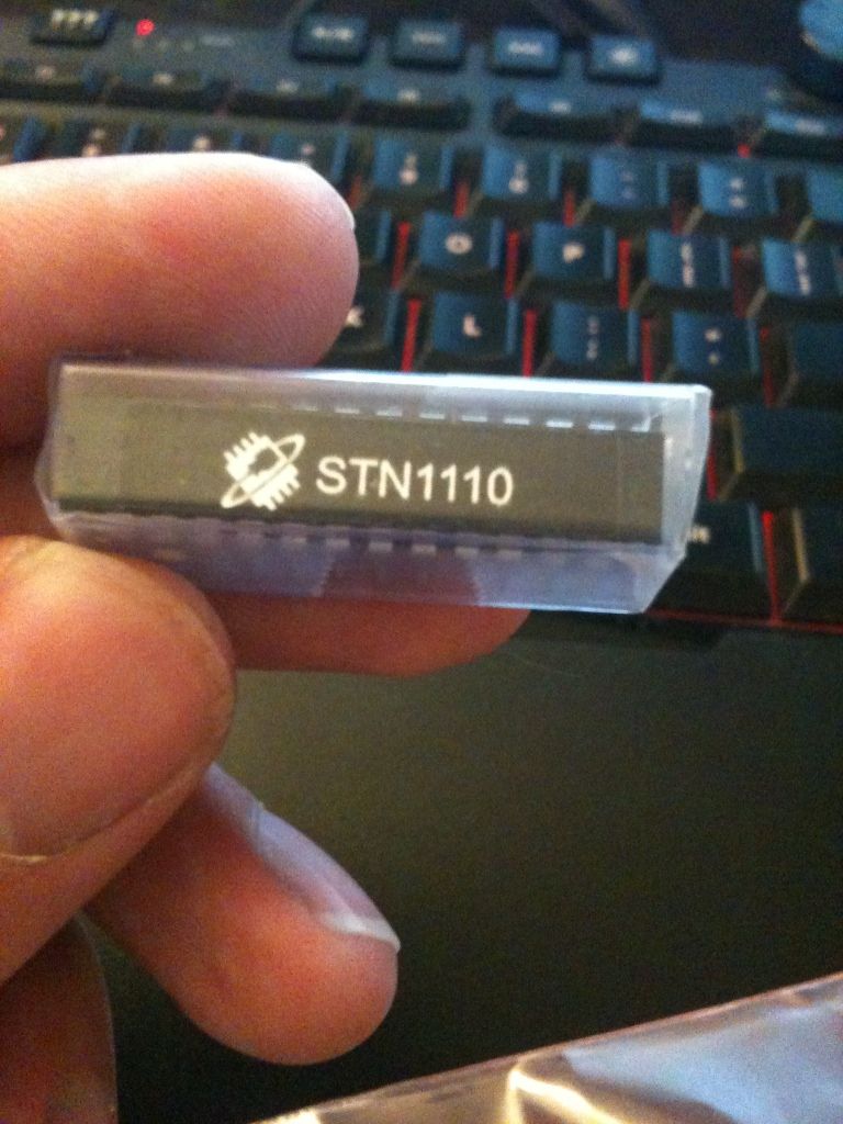

Hey guys, great thread. I'm looking to do a Carputer (CarPi) and definitely want OBDII interfacing. In my case, I just want to read from it - get things like MPG, IAT, timing advance, coolant temp, oil pressure, intake manifold pressure, etc.
Firstly, while I like the effort in this thread, I wish it would focus on more OPDII protocols than just CAN. Most cars out there are not CAN compliant - I'm in a 2002 Acura RSX-S which uses ISO9141 (afaik). CAN has only been mandatory since 2008, and as a cheapo computer system, I think the RPi is going to appeal to people that aren't driving modern cars lol.
In that regards, while the MCP2515 is a great CAN chip, why not go with a more "open hardware" friendly STN1110, which is still lightning fast with CAN but also compliant with other protocols? Additionally, it supports the "AT" command set (basically the same as used with modems) so I'm sure programming for it wouldn't be too difficult for someone of moderate skill (not me, sadly). Also, you can get a free sample (1 to 3). I asked for one and apparently it will arrive at my door in a few weeks. Can't beat free.
Finally there's a few hurdles besides just communicating with the RPi. My research is currently at this stage:
-Needs protected power.
Luckily this is covered for us by the STN1110 datasheet. See the datasheet on this page, go to page 12 on the PDF http://www.obdsol.com/stn1110/
-Needs 5V and 3.3V
This should be fairly simple. Use a pair of MCP16323 or similar buck chips after the power protection circuit, as described in the STN1110 data sheet. Additionally, the datasheet on these buck chips layout the ideal setup, just needs a few capacitors.

This is probably the hardest part. Building an STN1110 breadboard shouldn't be too bad, and you can certainly connect the 3 or 4 wires from the ECU directly to the inputs as listed in the data sheet, although it might get messy. Connecting it to the Pi is something else. One option is GPIO pins, possibly using the WiringPi library which is similar to Arduino. A lot of my info comes from researching the OBDuino projects that work quite well.

Amazing, I didn't know of this chip and I instantly ordered a sample. Thanks for the tip.Wolfram23 wrote:In that regards, while the MCP2515 is a great CAN chip, why not go with a more "open hardware" friendly STN1110, which is still lightning fast with CAN but also compliant with other protocols? Additionally, it supports the "AT" command set (basically the same as used with modems) so I'm sure programming for it wouldn't be too difficult for someone of moderate skill (not me, sadly). Also, you can get a free sample (1 to 3). I asked for one and apparently it will arrive at my door in a few weeks. Can't beat free.

My sample just arrived! Yay for free stuff!
Time to bust my butt and get a BoM made up and order this stuff!
