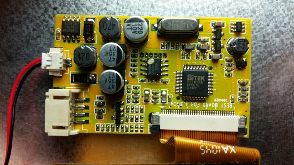

Posted: Thu Sep 18, 2014 1:20 am
by sirmodok
Has anyone seen one like this?
It's super compact compared to the other ones, and it's pretty pretentious too (according to the text on the board that says "Best board for 4.3 inch") I have a few guesses as to how to modify it to accept 5v based on reading this entire post and comparing some of the chips on mine to some in the pictures posted, but I'm afraid to just up and try it myself. I have very little electronic experience. I have put in a few mod chips and such, but always with detailed instructions.
Any help would be appreciated.
Re: Modifying a 3.5" car display for USB power.
Posted: Thu Oct 09, 2014 9:47 pm
by nox86
Thanks goes to Oeasis and boobatron3000
Large Image
btw, there is serial port: datasheet, firmware
my lcd: http://www.ebay.com/itm/171329340261
