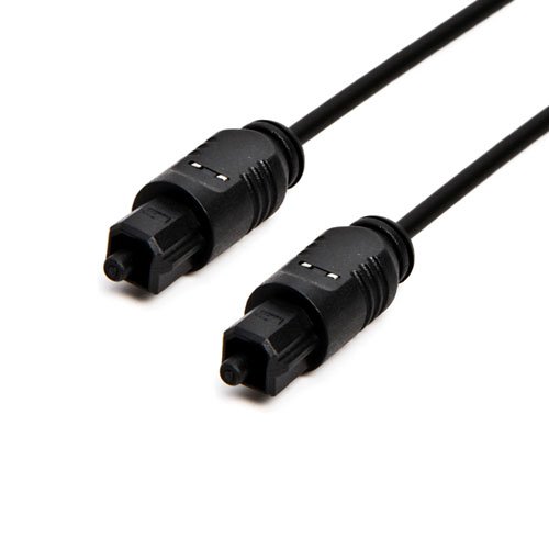

I had an idea for creating a flexible light pipe for the status LEDs.
Get a cheap TOSlink cable, e.g one of these:
The cable tends to be quite thin, but the actual optical part is about a millimetre across.
Chop the cable into several pieces, which isn't a problem as TOSlink cables are usually plastic.
In your casing drill a row of holes roughly the diameter of the optical cable and glue one of the each of the pieces flush with the surface of the casing.
The other end is the problem, which I haven't quite thought of an easy answer. I'm guessing a piece of plastic with a line of holes spaced to match the spacing of the LEDs on the RPi board. This plastic piece then needs to be held so that the ends of the optical cables are directly above the LEDs. It is holding it securely that I haven't been able to answer.

Mortimer wrote:I had an idea for creating a flexible light pipe for the status LEDs.
Would gentle heat apply a permanent bend? Trying to think of a small tube that would work...
