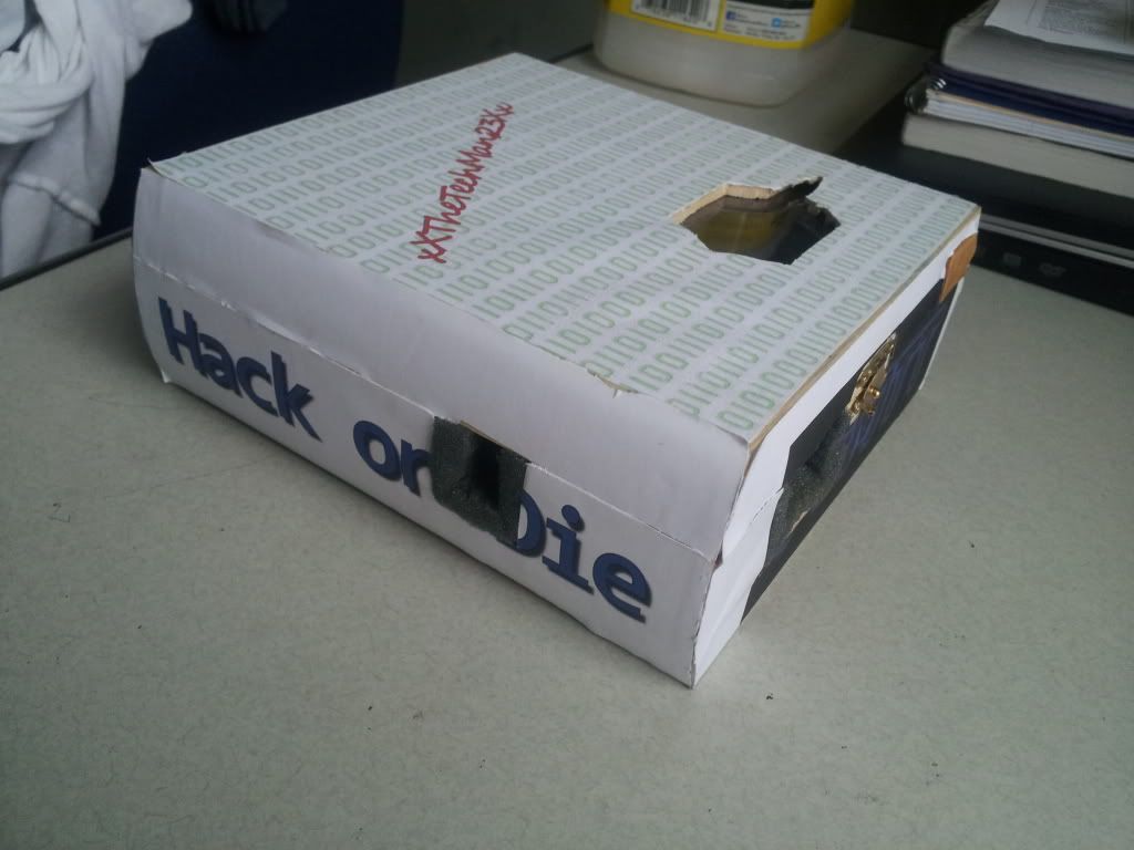

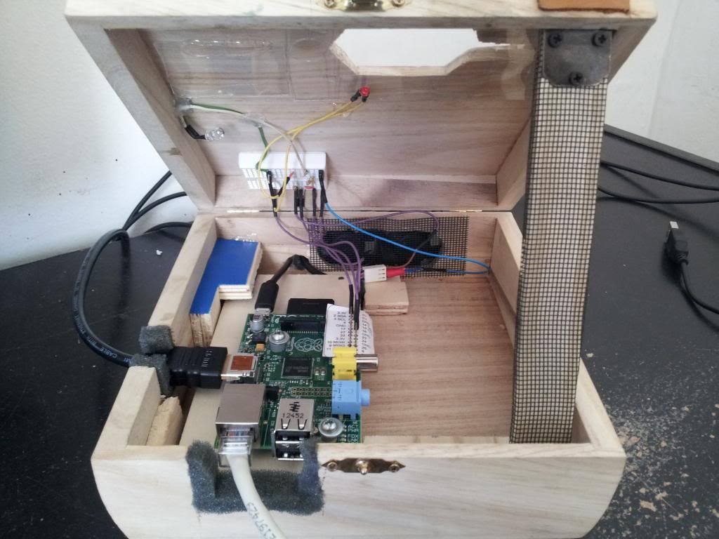

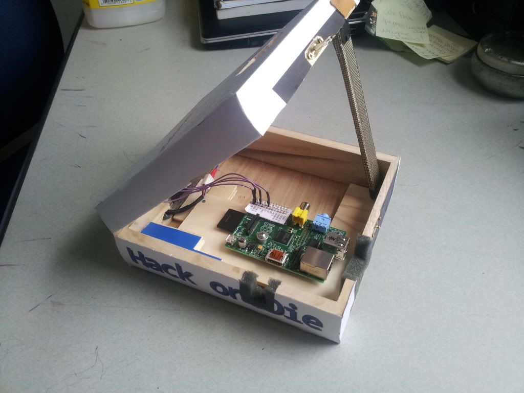

Custom fan box with python script for temperature control

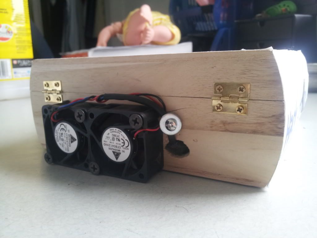

I built a box with fans attached to it to control the temp like a regular desktop would have. I wrote a python script that checks the temp of the CPU every 45 seconds and turns the fans on/off accordingly.

What fans are you running, what voltages, what pins.
Are they effective, and is there a plan for the box?
I have an 80x80mm 12v fan, will it work?

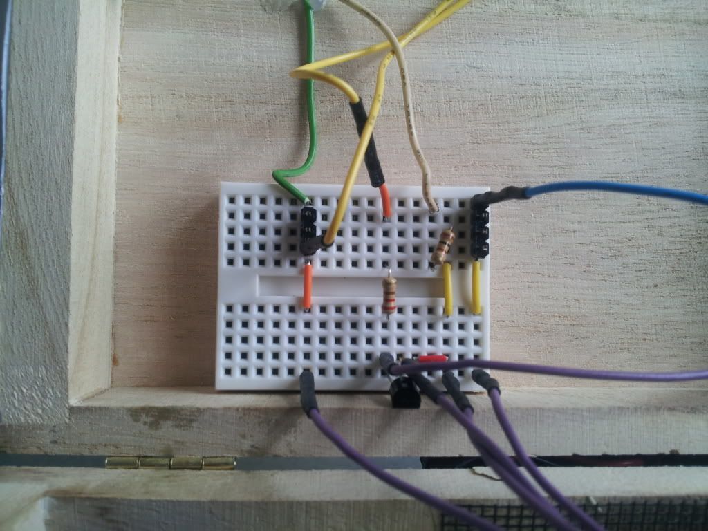

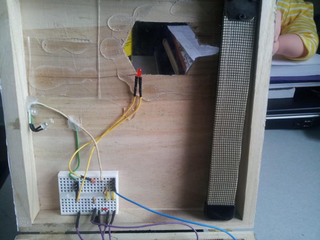

I used the 3v for led's and the 5v for the fan.... I pulled the fan out of an old pc but I think you can get low voltage fans at radioshack. I used the 12 pin to control the fans by sending a signal from the 12 pin to the transistor to turn the ground on and off. I have the ground for an led and the fan going to the same transistor that the 12 controls. If you link to the video you can see how I wired the setup a lot better!
