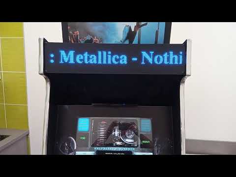

rpt007 wrote:
Mon Nov 19, 2018 11:36 pm
@Mike: Thinking of future enhancements -
Is there a way already today to display current playing title together with the artist, scrolling from right to left after x seconds ?
Or: is it a feature which requires a lot of programming for you to get it into a next version - if you plan any?
Raimund
Like this? (Click the image)

@Mayki:
looks very good. But you are using potentially a separate microcontroller for displaying the running information, isn't it?
Good idea, but for my project I wanna stay with the original outfit of my Wurlitzer as close as possible. Whenever the Wurlitzer project is finished (still a lot of mechanical and electrical work to do) I might build another Jukebox, more or less from scratch making use of an idle LCD screen, for my son's party room.
Raimund

I use one RaspberryPi, HDMI output to the main monitor, the GPIO is connected to the LED Matrix panel that displays the information.

Interesting, Mayki,
Could you explain a bit more, how you send the text via GPIO and what kind of led matrix you use?
Cheers
Raimund
Re: fruitbox MP3 jukebox
Posted: Thu Nov 22, 2018 4:19 pm
by Mayki
I use 3 panels.
My skin fruitbox.cfg contains:
[status]
Contents = status4.txt
Output = led.txt
status4.txt contains:
$IF_SONG_PLAYINGPRÁVĚ HRAJE : $NOW_PLAYING_ARTIST - $NOW_PLAYING_TITLE$END_IF$IF_NOT_SONG_PLAYING$IF_NO_CREDITS** VHOĎ MINCE ** A $END_IF$IF_NOT_SONG_PLAYING** VYBER PÍSEŇ **$END_IF
Bash script read every two seconds content led.txt.
Software to control LED panels is here.
Perhaps it is understandable with my poor English. :D

Mayki wrote:
Wed Nov 21, 2018 5:38 pm
Raimund
Hi Mayki,
That's a brilliant design. And the scrolling banner is superb.
One thing I noticed from the video; when the record loads there is a pause in the animation between the loading arm moving into position and the record spinning. This is because the SongLoadTime value in the skin config file is too big, and the video clip ends before the song load time expires (the animation is comprised of two different elements: a video for the loading and a status bitmap list for the record spin). If you reduce the value of SongLoadTime a little then you can remove this pause in the animation. As the value of the SongLoadTime is expressed in video frame ticks, I suspect you have a lower video frame rate than I had when developing the skin (you probably have 50Hz whereas I had 60Hz).
Cheers,
Mike
