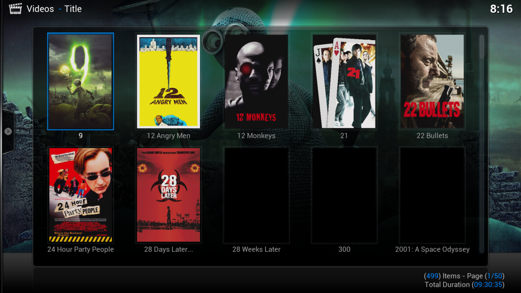

For instance, I get these errors when clicking on Movies (using Thumbnails view) - the following log entries relate to the process of displaying the first 10 thumbnails and fanart:sraue wrote: what for OMX errors? can you paste a log and tell when you get this? the wrong colored images seems like a xbmc problem too.
08:15:59 T:1233179744 NOTICE: Thread Background Loader start, auto delete: false
08:15:59 T:1074262016 ERROR: COMXImage::ReadFile special://skin/backgrounds/Skin default.jpg not found
08:15:59 T:1074262016 ERROR: Texture manager unable to load file: special://skin/backgrounds/Skin default.jpg
08:16:02 T:1207477344 ERROR: COMXCoreComponent::WaitForEvent OMX.broadcom.image_decode wait event 0x00000003 timeout 300
08:16:02 T:1215865952 ERROR: Previous line repeats 2 times.
08:16:02 T:1215865952 ERROR: COMXCoreComponent::GetInputBuffer OMX.broadcom.image_decode wait event timeout
08:16:03 T:1207477344 ERROR: COMXCoreComponent::WaitForEvent OMX.broadcom.image_decode wait event 0x00000004 timeout 1000
08:16:03 T:1207477344 ERROR: COMXImage::Decode m_omx_decoder.WaitForEvent result(0x80001009)
08:16:03 T:1182299232 ERROR: COMXCoreComponent::WaitForEvent OMX.broadcom.image_decode wait event 0x00000004 timeout 1000
08:16:03 T:1182299232 ERROR: COMXImage::Decode m_omx_decoder.WaitForEvent result(0x80001009)
08:16:03 T:1224791136 ERROR: COMXCoreComponent::WaitForEvent OMX.broadcom.image_decode wait event 0x00000004 timeout 1000
08:16:03 T:1224791136 ERROR: COMXImage::Decode m_omx_decoder.WaitForEvent result(0x80001009)
08:16:07 T:1207477344 ERROR: COMXCoreComponent::WaitForEvent OMX.broadcom.image_decode wait event 0x00000003 timeout 300
08:16:08 T:1215865952 ERROR: Previous line repeats 1 times.
08:16:08 T:1215865952 ERROR: COMXCoreComponent::WaitForEvent OMX.broadcom.image_decode wait event 0x00000004 timeout 1000
08:16:08 T:1215865952 ERROR: COMXImage::Decode m_omx_decoder.WaitForEvent result(0x80001009)
08:16:08 T:1224791136 ERROR: COMXCoreComponent::WaitForEvent OMX.broadcom.image_decode wait event 0x00000003 timeout 300
08:16:08 T:1207477344 ERROR: COMXCoreComponent::WaitForEvent OMX.broadcom.image_decode wait event 0x00000004 timeout 1000
08:16:08 T:1207477344 ERROR: COMXImage::Decode m_omx_decoder.WaitForEvent result(0x80001009)
08:16:08 T:1182299232 ERROR: COMXCoreComponent::GetInputBuffer OMX.broadcom.image_decode wait event timeout
08:16:09 T:1224791136 ERROR: COMXCoreComponent::WaitForEvent OMX.broadcom.image_decode wait event 0x00000004 timeout 1000
08:16:09 T:1224791136 ERROR: COMXImage::Decode m_omx_decoder.WaitForEvent result(0x80001009)
08:16:12 T:1135354976 ERROR: COMXCoreComponent::DecoderEventHandler OMX.broadcom.resize - OMX_ErrorInsufficientResources, insufficient resources
08:16:12 T:1182299232 ERROR: COMXCoreComponent::AllocOutputBuffers component(OMX.broadcom.resize) - OMX_UseBuffer failed with omx_err(0x80001000)
08:16:12 T:1182299232 ERROR: COMXImage::Decode m_omx_resize.AllocOutputBuffers result(0x80001000)
08:16:12 T:1224791136 ERROR: COMXCoreComponent::AllocOutputBuffers component(OMX.broadcom.resize) - OMX_UseBuffer failed with omx_err(0x80001000)
08:16:12 T:1224791136 ERROR: COMXImage::Decode m_omx_resize.AllocOutputBuffers result(0x80001000)
08:16:12 T:1182299232 ERROR: COMXCoreComponent::WaitForEvent OMX.broadcom.image_decode wait event 0x00000000 timeout 300
08:16:12 T:1182299232 ERROR: COMXCoreComponent::SetStateForComponent - OMX.broadcom.resize failed with omx_err(0x80001000)
08:16:12 T:1224791136 ERROR: COMXCoreComponent::WaitForEvent OMX.broadcom.image_decode wait event 0x00000000 timeout 300
08:16:12 T:1224791136 ERROR: COMXCoreComponent::SetStateForComponent - OMX.broadcom.resize failed with omx_err(0x80001000)
08:16:13 T:1215865952 ERROR: COMXCoreComponent::WaitForEvent OMX.broadcom.image_decode wait event 0x00000004 timeout 1000
08:16:13 T:1215865952 ERROR: COMXImage::Decode m_omx_decoder.WaitForEvent result(0x80001009)
08:18:41 T:1224791136 NOTICE: Thread Jobworker start, auto delete: true
08:18:42 T:1224791136 ERROR: COMXCoreComponent::AllocOutputBuffers component(OMX.broadcom.resize) - OMX_UseBuffer failed with omx_err(0x80001000)
08:18:42 T:1224791136 ERROR: COMXImage::Decode m_omx_resize.AllocOutputBuffers result(0x80001000)
08:18:42 T:1224791136 ERROR: COMXCoreComponent::WaitForEvent OMX.broadcom.image_decode wait event 0x00000000 timeout 300
08:18:42 T:1224791136 ERROR: COMXCoreComponent::SetStateForComponent - OMX.broadcom.resize failed with omx_err(0x80001000)
