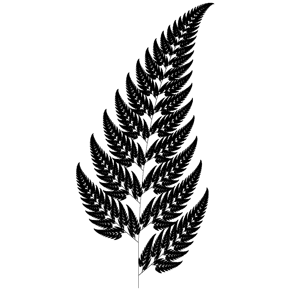

Here is a fern program in Julia
#  barnsley.jl -- Compute the Barnsley Fern
const N=8000000
const A=[[0.85 0.04; -0.04 0.85],
    [0.20 -0.26; 0.23 0.22],
    [-0.15 0.28; 0.26 0.24],
    [0.00 0.00; 0.00  0.16]]
const B=[[0.00, 1.60],
    [0.00, 1.60],
    [0.00, 0.44],
    [0.00, 0.00]]
const P=[0.85, 0.07, 0.07, Inf]
const cdf=[sum(P[1:i]) for i=1:4]
f(i,x)=A[i]*x+B[i]
i(p)=findfirst(x->p<=x,cdf)
const xmin=[-2.1820,0]
const xmax=[2.6558,9.9983]
const border=0.1
const scale=100.0
const nu=Integer.(floor.(scale*(xmax-xmin.+2*border)))
const image=zeros(Int8,nu...);
function plot()
    open("fern.pnm","w") do io
        println(io,"P1")
        println(io,size(image)[1]," ",size(image)[2])
        for iy=size(image)[2]:-1:1
            for ix=1:size(image)[1]
                print(io,image[ix,iy]," ")
            end
            println(io)
        end
    end
end
function point(x)
    coord=Integer.(floor.(scale*(x-xmin.+border)))
    image[coord...]=1
end
function main()
    println("barnsley.jl -- Compute Barnsley's Fern")
    xn=zeros(2)
    point(xn)
    for j=1:N
        xn=f(i(rand(1)[1]),xn)
        point(xn)
    end
    plot()
end
tsec=@elapsed main()
println("\nIteration rate is ",N/tsec," per second.")
println("Total execution time ",tsec," seconds.")
The Julia 1.6.0 Singularity container running on the 700 MHz ARMv6-based super-cheap cluster yields the output
Iteration rate is 31944.5234331074 per second.
Total execution time 250.434163363 seconds.
real    5m6.408s
user    4m48.460s
sys 0m13.240s
and the image
According to the super pet, speeds are a couple orders of magnitude faster on a Pi 4B running the official Julia 1.6.0 binary in 64-bit mode. I decided to not ask for details since Fido is still having problems with that nip routine.
jahboater
Posts: 6940

$ time ./fernbuf
fernbin.go -- Compute Barnsley's Fern
Iteration rate is 3.8271423178127375e+06 per second.
Total execution time 2.090332508087158 seconds.
real    0m2.102s
user    0m2.075s
sys 0m0.031s
about doubling the speed of the previous Go code. This change has an effect similar to buffering the pixel updates to the screen in a graphical program. It also raises the minimum performance expectations for Julia to reach the speed of a non-interactive language.

$ time ./fernpar
fernpar.go -- Compute Barnsley's Fern (GOMAXPROCS=4)
Iteration rate is 2.4541350919831693e+07 per second.
Total execution time 0.32598042488098145 seconds.
real    0m0.331s
user    0m1.279s
sys 0m0.001s
indicates what appears to be a super-linear performance increase.
What really happened is that by switching to per-thread random number generators I avoided the locking overhead of the default generator. Those gophers are now growing ferns so quickly that I'm not sure Julia will ever catch up. It is also tempting to go for greater resolution and create some print-quality output.

Here is a first attempt with Julia to catch up to those Go language gophers. Note there is no parallel processing at the moment and I'm still running the ARMv6 build in a Singularity container on the 700 MHz super-cheap cluster.
The new timing follows:
barnstat.jl -- Compute Barnsley's Fern
Iteration rate is 235426.10357255733 per second.
Total execution time 33.980938726 seconds.
real    2m54.498s
user    2m32.410s
sys 0m15.750s
Recall from
viewtopic.php?p=1853110#p1853110
that the original Julia code ran at 31945 iterations per second and took 250 seconds to finish. Thus, a few micro-optimizations resulting from minor changes have so far have resulted in more than a 7-fold performance improvement.
A significant performance improvement resulted by rewriting the point plotting function. The old version was
function point(x)
    image[coord...]=1
end
while the new one is
function point(x)
    i1=Integer(floor(scale*(x[1]-xmin[1]+border)))
    i2=Integer(floor(scale*(x[2]-xmin[2]+border)))
    image[i1,i2]=1
end
I'm at a loss to explain why the vectorized code is much slower than the new one. I think there is a way to examine the LLVM assembler output directly from the REPL, but I haven't taken a look to see what crazy things the original routine turned into.
The other improvement resulted from the StaticArrays package. While this led to a performance improvement of about 2-fold, I found it more significant that the package downloaded from the repository and installed without trouble. Given the highly experimental nature of this ARMv6 build I don't expect every package to work, but it seems that many do.
For reference the optimized code is
