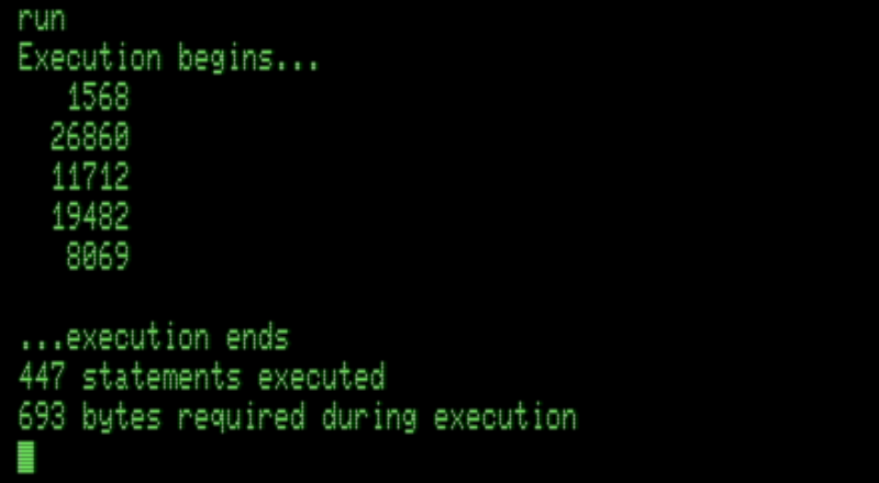

Back on the subject of random numbers, I'm having quite a time trying to construct a 32-bit unsigned multiply function using only 16-bit 2's compliment signed integers. While the only available arithmetic operations are addition, subtraction, multiply, divide and modulus, the main difficulty so far has been a corrupt SSD caused by what appear to be memory errors on the x86 PC that serves for my desktop. Who would have known those matched DIMMs would also function as a built-in hardware random number generator when paired in dual channel mode. It appears the random numbers do not arise from a quantum source, otherwise, I might have been able to fix the fault using a simple Jedi mind trick. If only the Pi 4B supported Zoom.
I now have a pseudorandom number generator for the SuperPET written in Waterloo Pascal which faithfully reproduces the exact same sequences as the 7th edition of historic PDP-11 Unix. All testing was done using a Pi 4B with the Versatile Commodore Emulator (VICE) and the History Simulator (SIMH).
The code running on the PDP-11 was
#include <stdio.h>
main(){
    srand(3141);
    printf("%u\n",rand());
    return 0;
and produced the output
$ cc -o r7rand r7rand.c
$ ./r7rand
1568
26860
11712
19482
8069
while the code on the SuperPET was
program main(output);
type int5=array [0..4] of integer;
var r7a,r7c,r7x:int5;
procedure r7init;
begin
    r7a[0]:=109; r7a[1]:=28; r7a[2]:=25; r7a[3]:=14; r7a[4]:=4;
    r7c[0]:=57; r7c[1]:=96; r7c[2]:=0; r7c[3]:=0; r7c[4]:=0;
    r7x[0]:=1; r7x[1]:=0; r7x[2]:=0; r7x[3]:=0; r7x[4]:=0;
end;
procedure r7mul(var r:int5;a,b:int5);
var i,j,c,p:integer;
begin
    c:=0;
    for i:=0 to 4 do begin
        r[i]:=c; c:=0;
        for j:=0 to i do begin
            p:=r[i]+a[i-j]*b[j];
            r[i]:=p mod 128;
            c:=c+(p div 128)
        end
    end;
    r[4]:=r[4] mod 16
end;
procedure r7add(var r:int5;a,b:int5);
var i,c,p:integer;
begin
    c:=0;
        p:=a[i]+b[i]+c;
        r[i]:=p mod 128;
        c:=p div 128
    end
end;
procedure r7seed(x:integer);
begin
    if(x>=0) then begin
        r7x[0]:=x mod 128;
        x:=x div 128;
        r7x[1]:=x mod 128;
        x:=x div 128;
        r7x[2]:=x mod 4;
    end else begin
        x:=x+16384+16384;
        r7x[0]:=x mod 128;
        x:=x div 128;
        r7x[1]:=x mod 128;
        x:=(x div 128)+2;
        r7x[2]:=x mod 4;
    end
end;
function r7rand:integer;
begin
    r7mul(r7x,r7x,r7a);
    r7add(r7x,r7x,r7c);
    r7rand:=(r7x[2] div 4)+r7x[3]*32+(r7x[4] mod 8)*4096
end;
begin
    r7init;
    r7seed(3141);
    writeln(r7rand);
    writeln(r7rand);
    writeln(r7rand);
    writeln(r7rand);
    writeln(r7rand);
end.
Woohoo! That's the exact same sequence, no psychokinetics needed!
Irritatingly, the random numbers took about one second each to generate. Still, reproducing the same sequence is an important step in making a version of Hunt the Wumpus with correct game dynamics for the SuperPET on Fido's birthday. Moreover, both emulators are using the built in hardware (namely the ALU) of the Raspberry Pi to generate random numbers.
If anyone sees a way to improve the speed of this pseudorandom number generator while staying within the constraints of using only the five arithmetic operators addition, subtraction, multiplication, division and modulus acting on 16-bit two's complement arithmetic, that would be very much appreciated.
Man that is spooky. Random numbers from the dead.

maths are not supposed to change even when resurrected from graves ;)

I now have a random graph generator written in Pascal which creates the exact same mazes as the 7th edition of Unix, though I think Ken's C code actually predates the 6th edition. As the construction of random graphs is somewhat tangential to random number generators in general, I'll continue the discussion of creating a birthday present for the SuperPET in a separate thread.
I'd agree it's a bit spooky. It's almost as if the original creator of Hunt the Wumpus has come back to life after having been cryogenically frozen.
