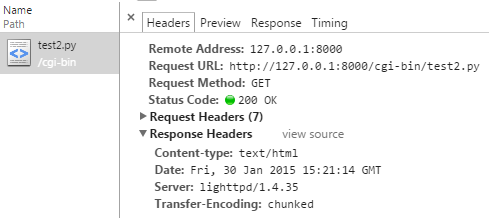

The HTTP spec does clearly say it has to be CRLF but I found out that either one of these work fine (lighttpd running under cygwin, chrome browser on Windows 7):
#!/usr/bin/python
print "Content-type: text/html"
print
print "<html>"
print "<head><title>Python test</title></head>"
print "<body>"
print "<H1>Python test</H1>"
print "</body>"
print "</html>"
#!/usr/bin/python
print "Content-type: text/html\n"
print "<html>"
print "<body>"
print "</body>"
print "</html>"
In browser:
Developer tools - headers (note the content type):
Developer tools - response (note the html starts on line 1):
...adding the second '\n' at end of the context type string only adds one more empty line - have to remember that Python print always adds a newline at the end (if not specifically told not to)!
Not sure if the httpd does the LF -> CRLF conversion but as it worked for the OP I assume it does. I even ran the scripts on command line redirecting output to file and checked that there are only LFs in the output:
As it comes to the subprocess.call issue, it appears that the newline created by the echo command gets first into the response output stream - no matter at what point in the script it is! And of course the empty line before the content type gets the browser confused:
This becomes more apparent if we output something other than just the empty line:
print
print "<html>"
print "<body>"
call(["echo", "testing"], shell=False)
print "</body>"
print "</html>"
...which is equivalent to the shell command 'echo testing' - so using os.system would be:
#!/usr/bin/python
from os import system
print
print "<html>"
print "<body>"
system("echo testing")
print "</body>"
print "</html>"
and produces:
Now if instead of a (by bad luck) pathological test-case with the echo, the OP would have put in the actual call to the GPIO script, it would have worked (assuming the script would not output to stdout == use print() etc.)!
Now it would be interesting to know if the Perl version calling the echo would fail as well?
http://raspberrycompote.blogspot.com/ - Low-level graphics and 'Coding Gold Dust'
