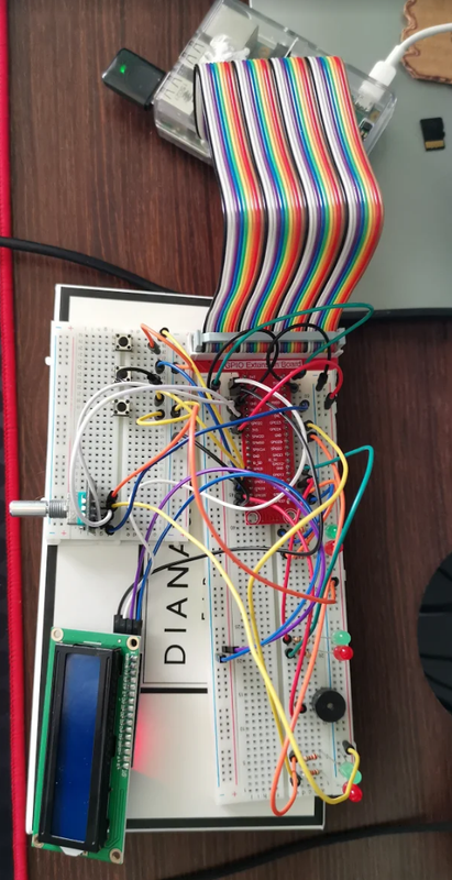

I have completed my first PI project. It is rather simple consisting of: 6 LEDS, 1 Buzzer, 3 Push Buttons , one Rotary Encoder and one LCD 2x16.
It communicates over the network a PC that runs Microsoft Flight simulator and serves like a general purpose panel.
I am completely noob when it comes to the next steps. What i would like to do is to put all of these in a box and mount them as i like. Also i would like to drop the breadboards but i think that going to PCB is huge step forward.
The problem is i don't know where to start :)
I imagine that i could have a PCB that accepts the 40pin connector from PI and then connect on that PCB my devices with long cables enough to mount them in the right places in the box.
I need help on where to start and how. Should i design the circuit myself and give it to someone to create the PCB or i could buy stuff and with soldering i could create my PCB?
