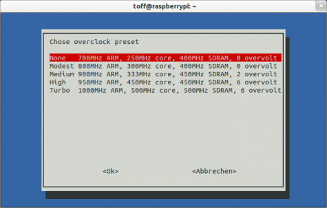

I have it from the official raspbian rpi-config overclocking presets, look here:

I played with many settings, I just picked out two configs I had in mind. As fas as I can see, corruption always kicks in with over_volt regardless of every other setting. (At least in my case)
