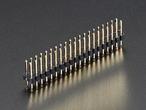

I was installing RTC to raspberry Pi and soldered only those 6 pins that are used to attach RTC clock, so I am curious if I need to solder the rest?
I soldered only 1,2,3,4,5,6.
This is the type of pins used: Image
Just wondering if there is any electrical circuit involved that will cause some troubles if not all pins are soldered.

Those are designed to be cut to size. You can see the marking for where to divide between the pins so you can use side cutters or similar to remove the extra pins and save for use in the future.

It should be fine leaving it as is.

It should be fine, but I would simply solder all the pins because it's practice and it does add a bit of rigidity to the entire connector. It's not like it takes hours!

soldering pins 39 and 40 (the far end of the header) will give it better stability that it is now.
however, as with the others before me I recommend soldering all remaining pins as well.

Replace that Zero with a Zero WH (header already soldered in) and save that one without pins for another project.

I believe some attachments rely on the unused pins to be soldered for tensile strength - a hat or similar wants to populate 40 pins, and only 6 at one end might not be enough to hold it in place.

I use standoffs when possible to firmly hold my pHat or Hat in place. I don't rely on the GPIO connection to hold things in place. I'm not saying its a bad thing to do, just that I try to avoid it if possible.
And for what its worth, the RTC that the OP connected only has a 6 pin header and is postage stamp sized. It only requires power and the two i2c pins.
