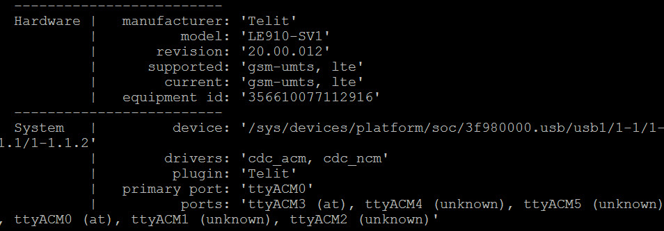

I'm using a Telit USB modem. When I plug it into the latest Stretch image, I see it enumerate as several USB ports.
I want to send AT commands to it. But when I try, I get a port busy (I think). I've tried using both Screen and Python script to send AT commands. The python script returns an error that the port is busy. Screen just terminates without giving a reason.
I've included what my inputs and outputs are below. I do have modem and network manager installed, but it's not set to autoconnect.
Here's the output from Screen (I think ACM3 should be the correct port, but I tried both).

Here's the mmcli output. It seems to indicate that ttyACM3 is for AT commands.

if you are running Stretch with Desktop, it could be that ModemManager has grabbed the ports.
try
sudo systemctl stop ModemManager
and see if the ports are then acessible.
