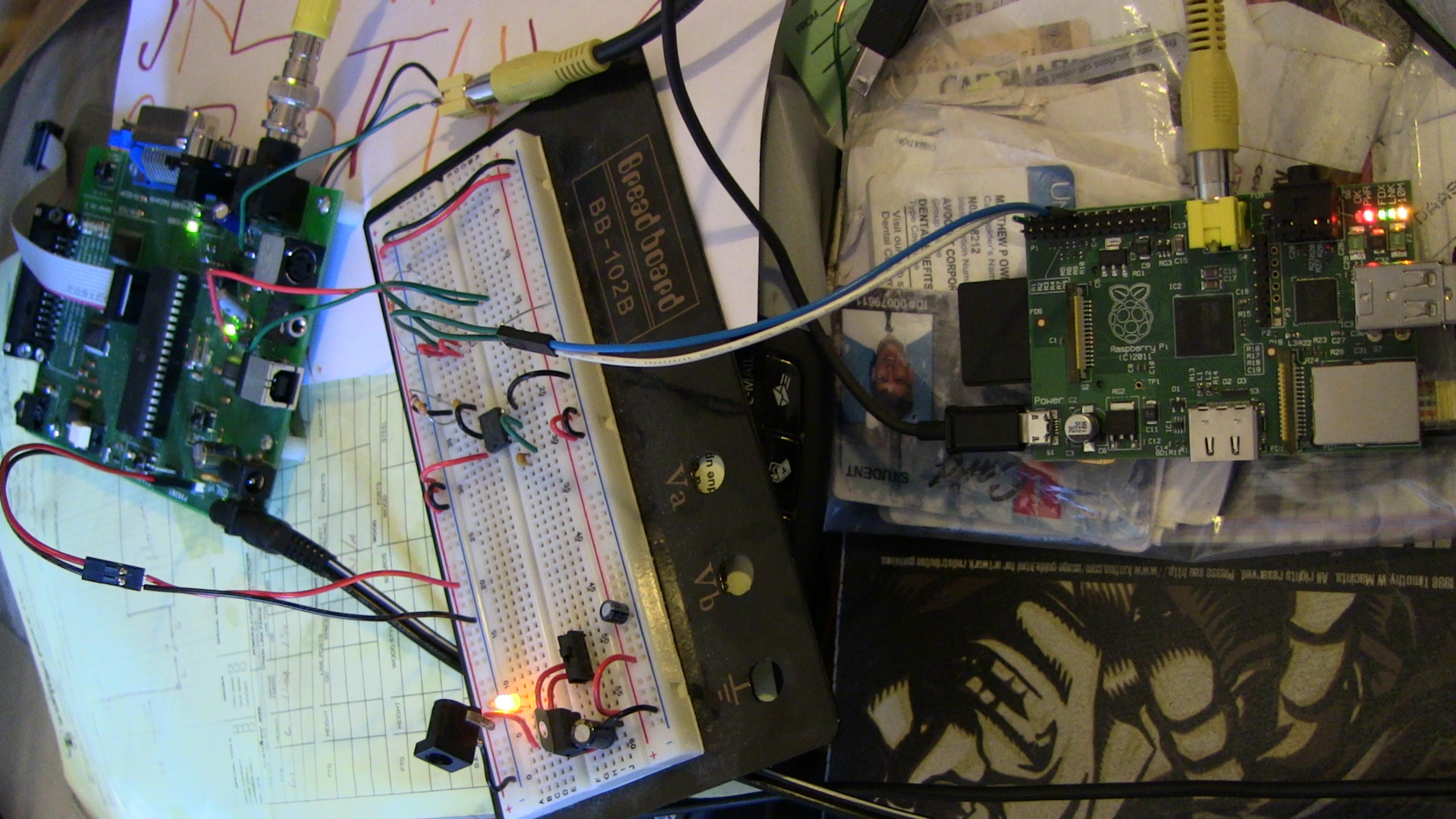

Welp, I successfully got the GPIO UART working (using a 330ohm and 680ohm resistor because that's all I had lying around) and it _seems_ to be working. It does lock up randomly but I haven't found where the lockup is occurring yet.
