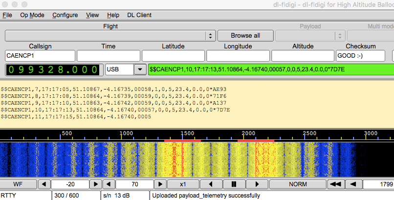

Couple of pictures:
gqrx output:
dl-fldigi output:
Re: PITS and Pi Zero Auto Start

I suddenly realised anyway that I with dl-fldigi in online mode it automatically uploads to HabHub, so inadvertently I had a payload called 'CHANGEME' for the world to see, how embarrassing - school boy error.
