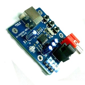

- Posts: 16
- Joined: Tue Oct 09, 2012 2:54 pm
For $14, it's well work getting this card for music, the quality is excellent and many have used it with the Pi including myself. Sure it adds a extra component, but if you're looking for a decent music out of the Pi, this is the route to take for short dollars!
http://www.aliexpress.com/store/product ... o_detail_a
or via ebay
http://www.ebay.com/itm/PCM2704-USB-DAC ... 2ec525964c
or via ebay
