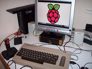

We got Vice working on our RPi and we even managed a face-off with a real C64
Pictures coming soon…

Pictures here:
http://zuzebox.wordpress.com/2.....-face-off/
Pictures here:
Tony
