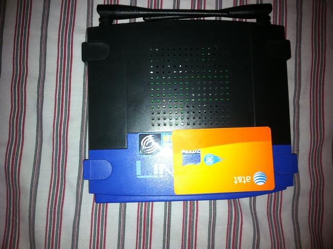

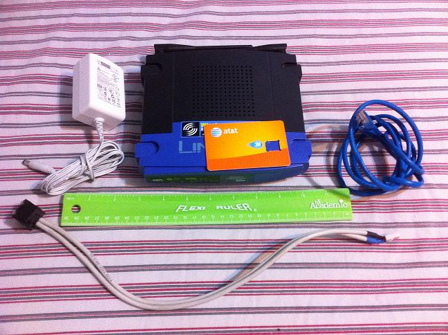

Here are some pictures of the equipment I have started gathering
This is an overview. A 12 volt 2 amp power adaptor, A WRT54GS ver7.2 router, Blue CAT 5E and a USB 2 port pigtail to bring the USB to the outside. Currently the plan is to mount the RasPi bottom up and put the video connectors out the front. The USB's and the SD card slot will be towards the back. The power input will be towards the center. The audio and Ethernet will be towards the right side. still trying to figure out how to get the 2.5" 320GB in there someplace.
12 volt 2 amp power
This is approximately where the RasPi will be placed inside
12 volt 2 amp power

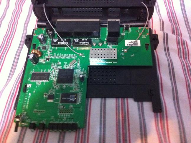

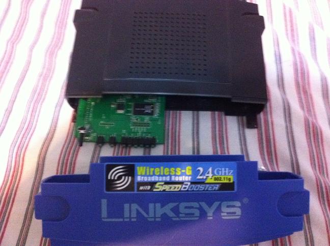

Here are some inside veiws.
The front of the router open.
Case completely opened. The antennas are part of the rear/bottom case.
This is the bottom of the board. In the upper right you can see the four square solder pads. That is where the older antenna attached. To the left of that is three pads. These are the power pads I will solder in here to carry power to the RasPi through a pigtail with barrel connector. Just left and slightly lower is the Ethernet port #4 solder pads. I will have to figure out the lines as I intend to Solder in an Ethernet pigtail to plug into the RasPi board.

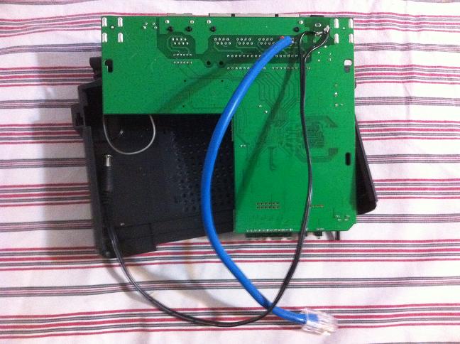

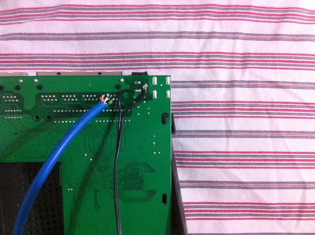

Soldered in a RJ45 pigtail and a 12v barrel connector today.
Soldering to those post sticking out of the board was not any fun! The trick was to tin the
wires and post. Only 4 wires are needed for 10/100. Orange/White to pin 1, Orange to
pin 2, White/Green to pin 3 and Green to pin 6. The row nearest the back is odd the row
farthest from the back of the cae is even.
The power leads were a lot easier! The strain releif was removed from the CAT5E
connector. the wires travel under the router board up to the front.
The open router is plugged into a Emachine netbook.

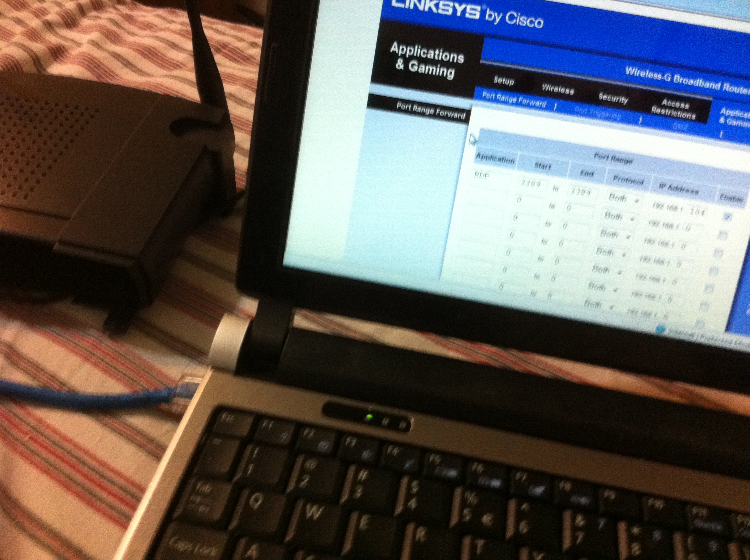

The router is working just fine, as you can see here!

Booted the netbook into Lubuntu and the wireless client mode works just fine. No problem getting to the internet.
Experimented a bit with it. I was able to connect to the internet wired but had to turn off client mode and plug into the WAN port. DD-WRT has a setting to turn the WAN port into a standart port when in client mode. So you could have 4 ethernet ports. The RasPi will have port #4. If the RasPi were turned off you would still have 4+1 as a simple router. I placed a connector in the port to block it when in use by the internal CAT5E.
